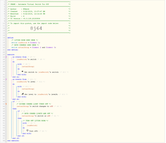

Could you whip it up? I’m taking kids to the zoo and seeing the actual code is better for me than to try to frustratedly build it lol.
Sure thing. It might take me 10 minutes or so.

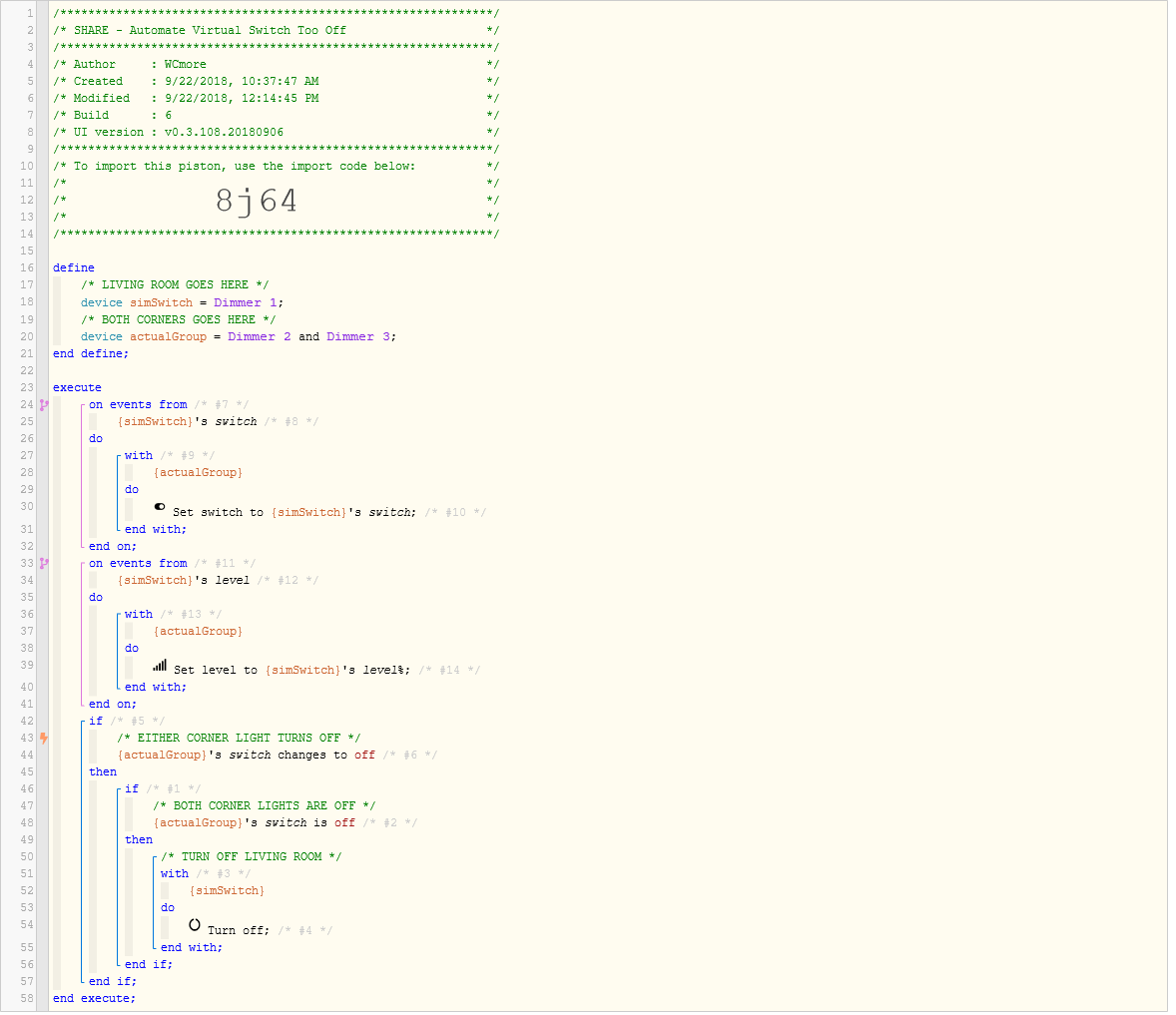

(I am going to try to consolidate it all into one piston)
This will replace BOTH of your pistons by rolling all the commands into this one.
(To test this properly, make sure you pause all other living room pistons (including CoRE))
I added a few comments (in green) so you can double check to make sure the right devices are in the right location.
