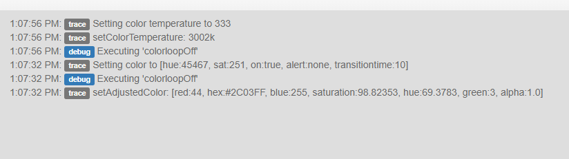

here you can see me change color to some blue using app, then 24 seconds later to 3002k with app…
note the data… no adjustment in hsl for color temp
