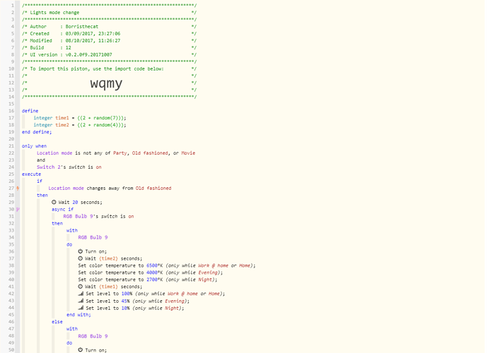

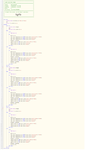

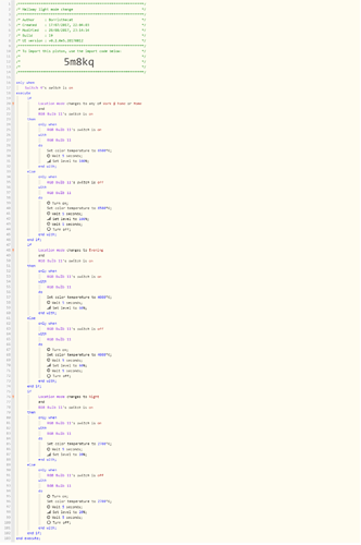

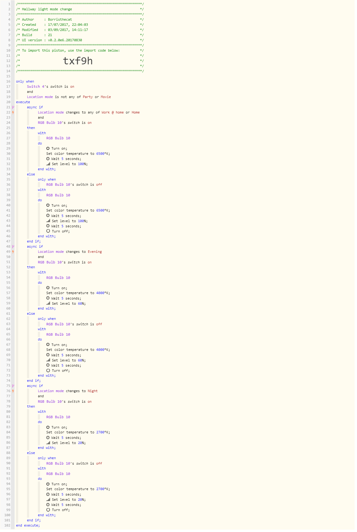

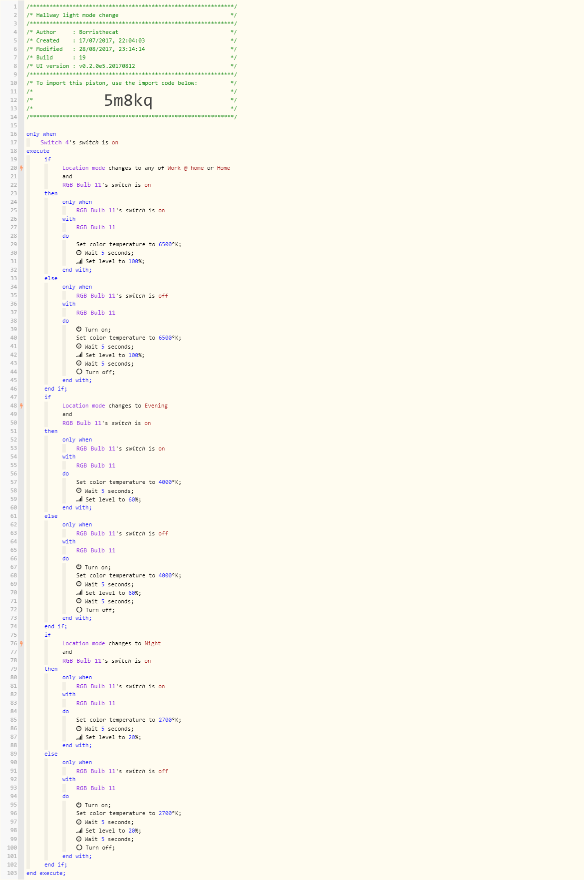

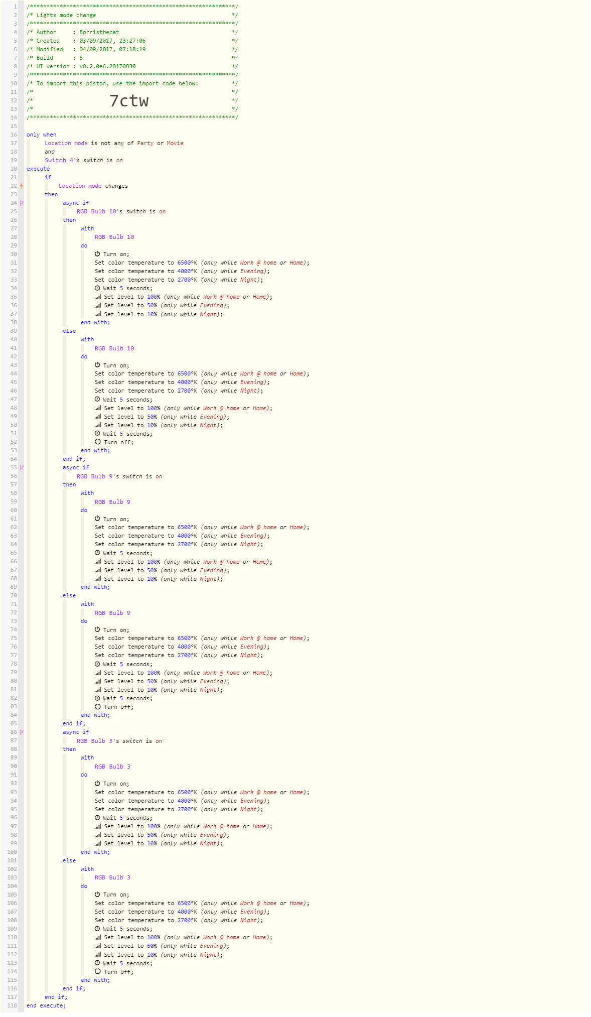

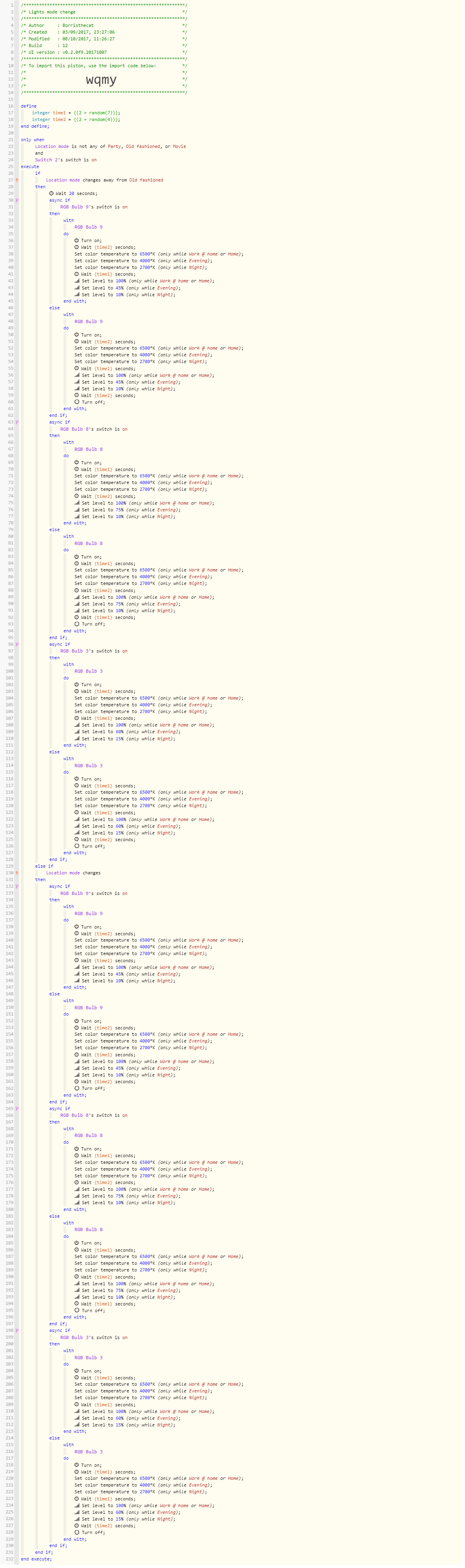

ok so this is the last bug i have and the logs. When i went to home from evening it sent the evening temperature and level? any ideas
28/08/2017, 22:15:26 +143ms
+0ms ╔Received event [Home].time = 1503954926965 with a delay of -823ms
+247ms ║RunTime Analysis CS > 20ms > PS > 61ms > PE > 166ms > CE
+260ms ║Runtime (45866 bytes) successfully initialized in 61ms (v0.2.0e5.20170812) (259ms)
+261ms ║╔Execution stage started
+339ms ║║Executed physical command [Hallway].off() (24ms)
+340ms ║║Executed [Hallway].off (26ms)
+342ms ║║Condition #71 evaluated true (37ms)
+343ms ║║Condition group #70 evaluated true (state did not change) (40ms)
+353ms ║║Comparison (string) :00a05f15f14bac7fcf8b8b721fbdb88b: changes_to (string) :964d0cd483c8df461f20eef29b039dab: = false (1ms)
+355ms ║║Condition #48 evaluated false (7ms)
+357ms ║║Condition group #38 evaluated false (state did not change) (9ms)
+368ms ║║Comparison (enum) on is (string) off = false (3ms)
+371ms ║║Cancelling condition #73’s schedules…
+372ms ║║Condition #73 evaluated false (14ms)
+373ms ║║Cancelling condition #72’s schedules…
+374ms ║║Condition group #72 evaluated false (state changed) (17ms)
+379ms ║╚Execution stage complete. (117ms)
+389ms ╚Event processed successfully (390ms)
28/08/2017, 22:15:21 +558ms
+1ms ╔Received event [Home].mode = Home with a delay of 89ms
+219ms ║RunTime Analysis CS > 20ms > PS > 64ms > PE > 135ms > CE
+230ms ║Runtime (45869 bytes) successfully initialized in 64ms (v0.2.0e5.20170812) (228ms)
+232ms ║╔Execution stage started
+250ms ║║Comparison (enum) on is (string) on = true (2ms)
+252ms ║║Condition #19 evaluated true (12ms)
+253ms ║║Condition group #null evaluated true (state did not change) (15ms)
+265ms ║║Comparison (string) :00a05f15f14bac7fcf8b8b721fbdb88b: changes_to_any_of (string) :11caac43340ed2b1de78f41f4f00219f:,:00a05f15f14bac7fcf8b8b721fbdb88b: = true (4ms)
+268ms ║║Cancelling condition #16’s schedules…
+269ms ║║Condition #16 evaluated true (11ms)
+270ms ║║Cancelling condition #1’s schedules…
+272ms ║║Condition group #1 evaluated true (state changed) (15ms)
+286ms ║║Comparison (enum) off is (string) on = false (3ms)
+289ms ║║Condition #61 evaluated false (12ms)
+290ms ║║Condition group #58 evaluated false (state did not change) (15ms)
+300ms ║║Comparison (string) :00a05f15f14bac7fcf8b8b721fbdb88b: changes_to (string) :aedfd61dabbaf2b5c3fc647f35488f2d: = false (1ms)
+303ms ║║Condition #36 evaluated false (7ms)
+304ms ║║Condition group #26 evaluated false (state did not change) (9ms)
+315ms ║║Comparison (enum) off is (string) off = true (3ms)
+317ms ║║Cancelling condition #71’s schedules…
+321ms ║║Cancelling statement #27’s schedules…
+348ms ║║Executed physical command [Hallway].on() (23ms)
+348ms ║║Executed [Hallway].on (25ms)
+372ms ║║Executed physical command [Hallway].setColorTemperature([4000]) (18ms)
+373ms ║║Executed [Hallway].setColorTemperature (20ms)
+399ms ║║Executed physical command [Hallway].setLevel([60]) (21ms)
+400ms ║║Executed [Hallway].setLevel (22ms)
+405ms ║║Executed virtual command [Hallway].wait (1ms)
+407ms ║║Requesting a wake up for Mon, Aug 28 2017 @ 10:15:26 PM BST (in 5.0s)
+412ms ║║Condition #71 evaluated true (106ms)
+413ms ║║Cancelling condition #70’s schedules…
+414ms ║║Condition group #70 evaluated true (state changed) (109ms)
+424ms ║║Comparison (string) :00a05f15f14bac7fcf8b8b721fbdb88b: changes_to (string) :964d0cd483c8df461f20eef29b039dab: = false (1ms)
+426ms ║║Condition #48 evaluated false (7ms)
+428ms ║║Condition group #38 evaluated false (state did not change) (8ms)
+439ms ║║Comparison (enum) off is (string) off = true (3ms)
+441ms ║║Cancelling condition #73’s schedules…
+445ms ║║Cancelling statement #39’s schedules…
+468ms ║║Executed physical command [Hallway].on() (20ms)
+469ms ║║Executed [Hallway].on (21ms)
+491ms ║║Executed physical command [Hallway].setColorTemperature([2700]) (17ms)
+492ms ║║Executed [Hallway].setColorTemperature (19ms)
+520ms ║║Executed physical command [Hallway].setLevel([20]) (23ms)
+521ms ║║Executed [Hallway].setLevel (25ms)
+526ms ║║Executed virtual command [Hallway].wait (1ms)
+528ms ║║Requesting a wake up for Mon, Aug 28 2017 @ 10:15:27 PM BST (in 5.0s)
+533ms ║║Condition #73 evaluated true (103ms)
+534ms ║║Cancelling condition #72’s schedules…
+535ms ║║Condition group #72 evaluated true (state changed) (107ms)
+540ms ║╚Execution stage complete. (309ms)
+543ms ║Setting up scheduled job for Mon, Aug 28 2017 @ 10:15:26 PM BST (in 4.865s), with 1 more job pending
+583ms ╚Event processed successfully (582ms)
