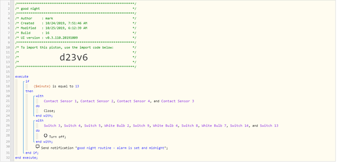

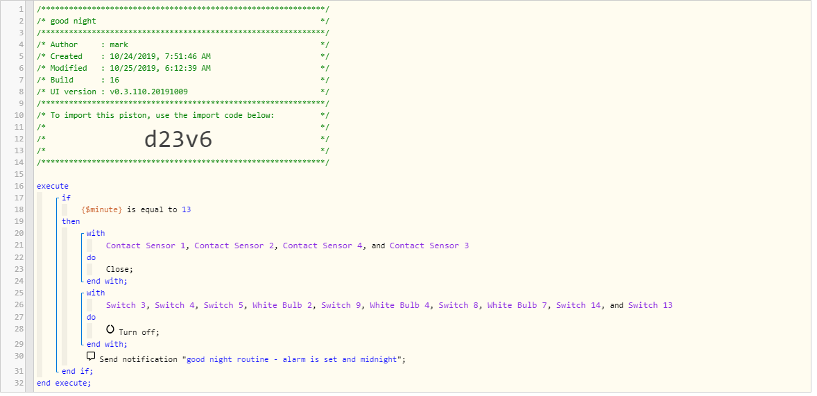

I’m trying to shut lights off at a certain time. I’m using minutes to make sure I have the conditions correct, but it’s nothing is happening. I tried to use “trigger” for time. “changes to” but that didn’t work either. I"m obviously missing something fundamental here.
There is no lightning symbol to the left of the code, this tells me that nothing is subscribed, which means there is no trigger to run this code.
you want a timer in there instead of the if statement.
System variables (such as $minute) do not make a good trigger.
They do work well as a condition though.
