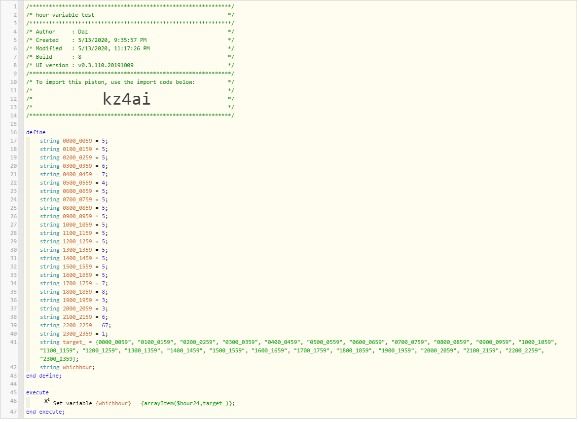

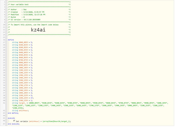

I think I’m nearly there. This looks a bit awful as promised, but allows me to use my old UI-friendly (?) format…
running the piston now (my time here is 2319 currently) sets “whichhour” variable as “1”. Which is what I wanted.

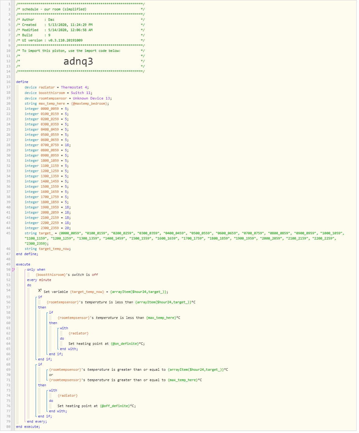

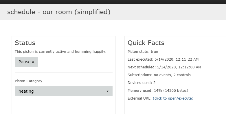

Well, that took a few hours of trial and error, but thought you may like to see the result.
Original piston (518 lines, 75K, very cumbersome to edit) - can’t even do a green cap because it slows my machine trying to do it!) :
New piston (75 lines, 14K, speedy and beautiful to edit
Cheers !!
