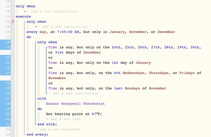

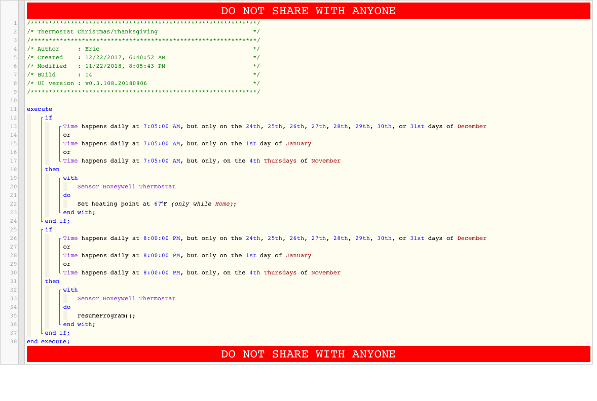

Trying to figure out why my thermostat didn’t resume program at 8pm on 4th Thursday or November
Thermostat to resume program at 8pm on 4th Thursday of November
