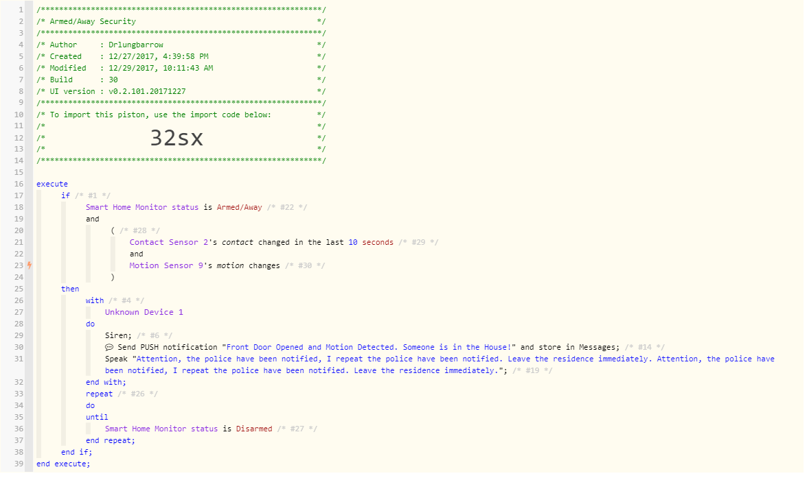

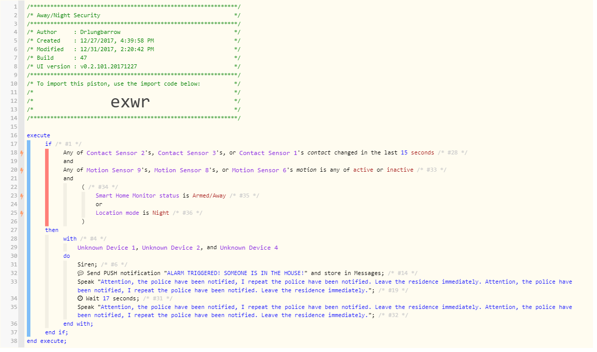

I am attempting to make a piston which handles my home security more efficiently then the SHM. I often get some false motion alerts due to animals etc when I utilize the SHM built into Smartthings. My idea was to utilize multiple triggers to initiate an intrusion alert (Like front door open and front entrance motion detector senses motion - therefore someone did just enter the house).
This will also trigger other things to occur, like a siren going off and an announcement that the police are on the way etc.
The piston does not appear to be triggering properly. I am not sure if I just need to make some simple modifications to make it work.
It seems to read that it is in the current SHM mode (away), but since the other triggers are not occurring (door contact open and motion sensor triggering motion) the piston ceases. When I go back and trigger the other contact and motion sensor the piston still will not fire.
Appreciate any assistance or recommendations to add additional things to the piston. I am still fairly new to WebCore!
