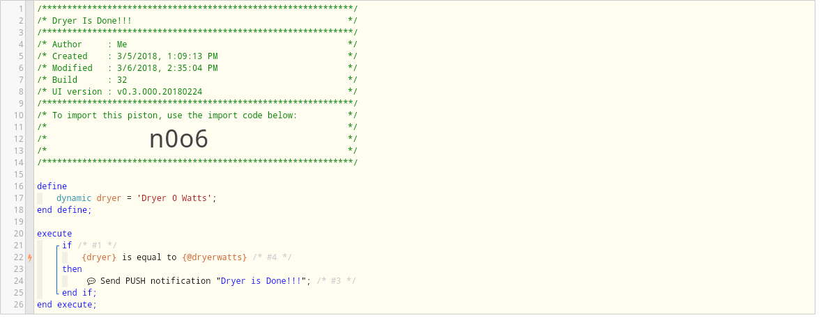

Sorry, this is not the right upload

What do you get for this one? (dryer == @dryerwatts ? 'yes' : 'no' )
#24
(expression) (dryer == @dryerwatts ? ‘yes’ : ‘no’ ) »»» (string) no
#25
and if you entered dryer and @dryerwatts in the console?
#26
expression) @dryerwatts »»» (dynamic) Dryer 0 Watts
(expression) dryer »»» (dynamic) Dryer 0 Watts

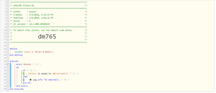

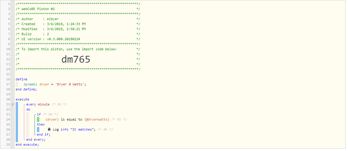

I’m at a loss… I can get mine to evaluate correctly.
|+154ms|║║Comparison (dynamic) Dryer 0 Watts is_equal_to (dynamic) Dryer 0 Watts = true (2ms)|
|+157ms|║║Condition #5 evaluated true (11ms)|
|+158ms|║║Condition group #2 evaluated true (state did not change) (12ms)|
|+162ms|║║Cancelling statement #3's schedules...|
|+173ms|║║It matches|
#28
I would like to use that but I would get a push every minute.

Oh that’s just for testing… you can actually drag that if statement out of the timer…I think it will let you :slight_smile:
Edit: Yep, it will. Just delete the timer after.
#30
Tried it, no match after I move it.
That’s gotta be a bug

I got it working. Had to do a “changes to”
#32
Ok, I was able to change it with a program that just changes the global from 1 Watts waits 5 seconds and then back to 0 Watts, it did the push.
@ipaterson, this may be the second time I have stumbled upon this bug.
#33
This seems to show the problem with your earlier attempts, the value from your device is split into three lines so rather than comparing against Dryer 0 Watts you would need to compare against
'Dryer
0
Watts'
