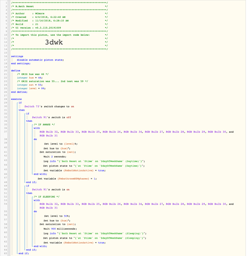

to get the lights back to where they were you’ll need to use variables.
You’ll need to save all the attributes to variables once the motion detected… After the blue flashing warning, you’ll assign them back to the bulbs.
here is an example of how to save lights status to variables.
