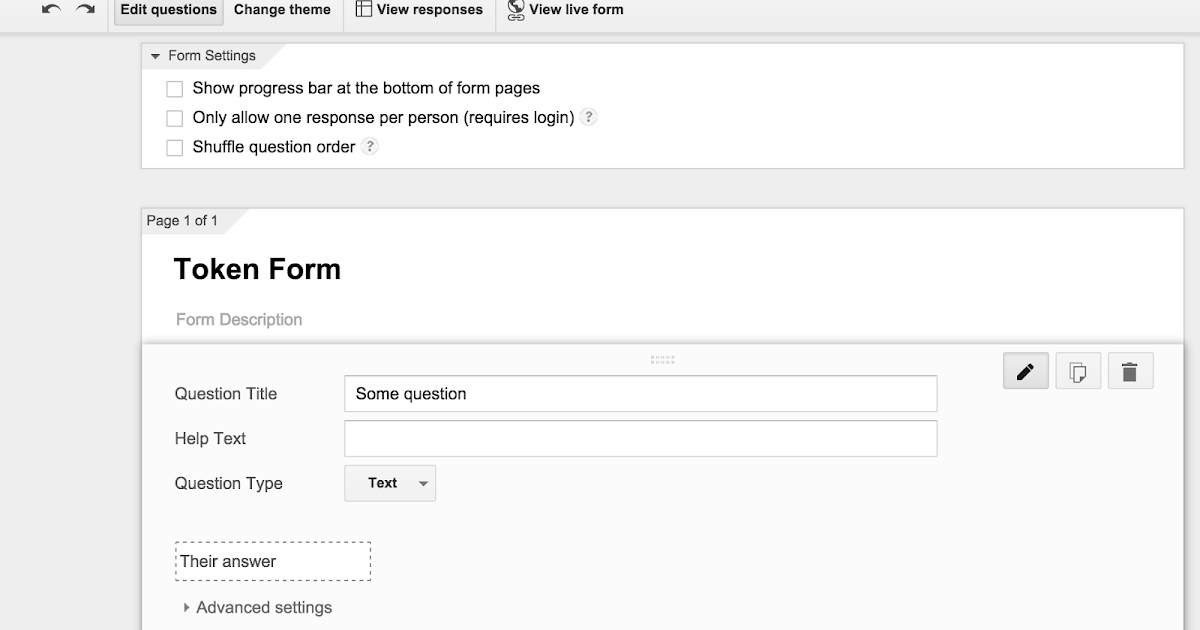

Also try this form method. It works a teat and doesn’t require opening access to the Sheet to public.
Thanks for this idea - it was helpful for creating my own event log to Google Sheets. I just implemented the same approach, but instead of the CURL command (like in that document), I’m making web posts directly from WebCore. I have a piston set up just for logging and it detects various changes (doors, windows, location mode, etc) and logs to the Google Sheet. Here’s an excerpt:
