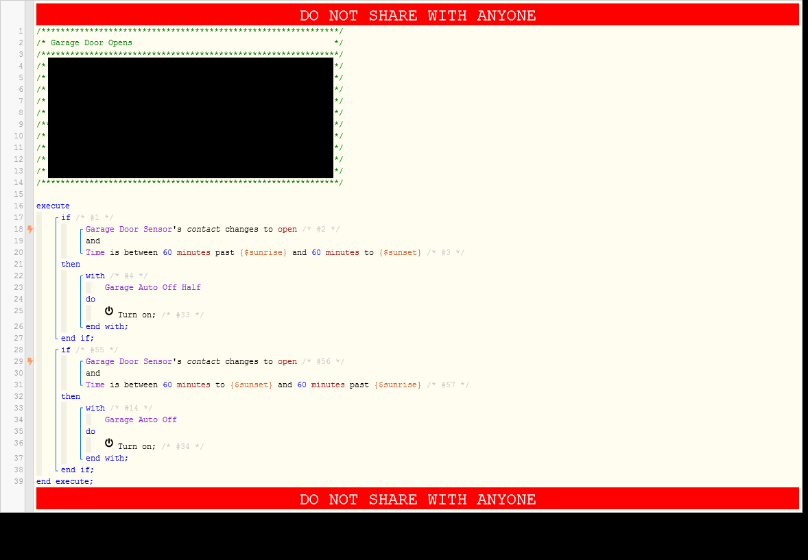

Ok, here are my Garage light pistons. There are actually 6, not 5 as I mentioned earlier.
I used the RED instead of Green, so that the names of things make more sense. Also, my naming of the pistons might not be the best, but they make sense for me.
Also, keep in mind that I am a heavy user of ActionTiles, and some of the coding is for this.
- Garage Door Opens.
a. Depending on the time, half or all of the lights will turn on.

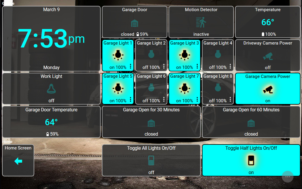

b. “Garage Auto Off” and “Garage Auto Half Off” are On/Off Button Tiles that tie into the later pistons. These buttons are also on my ActionTiles, and can be used to turn on/off half or all of the lights.

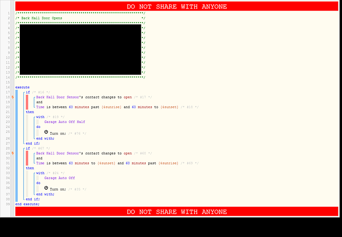

- Back Hall Door Opens.
a. Basically the same setup as “Garage Door Opens”, but triggered by the Back Hall Door which leads into the garage from the house.

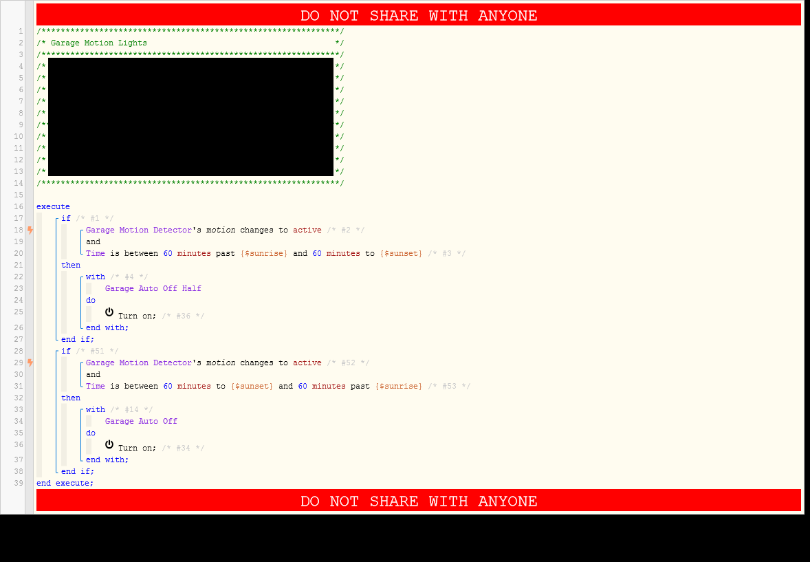

- Garage Motion Lights.
a. Basically the same setup as the previous two, but triggered by motion in the garage.

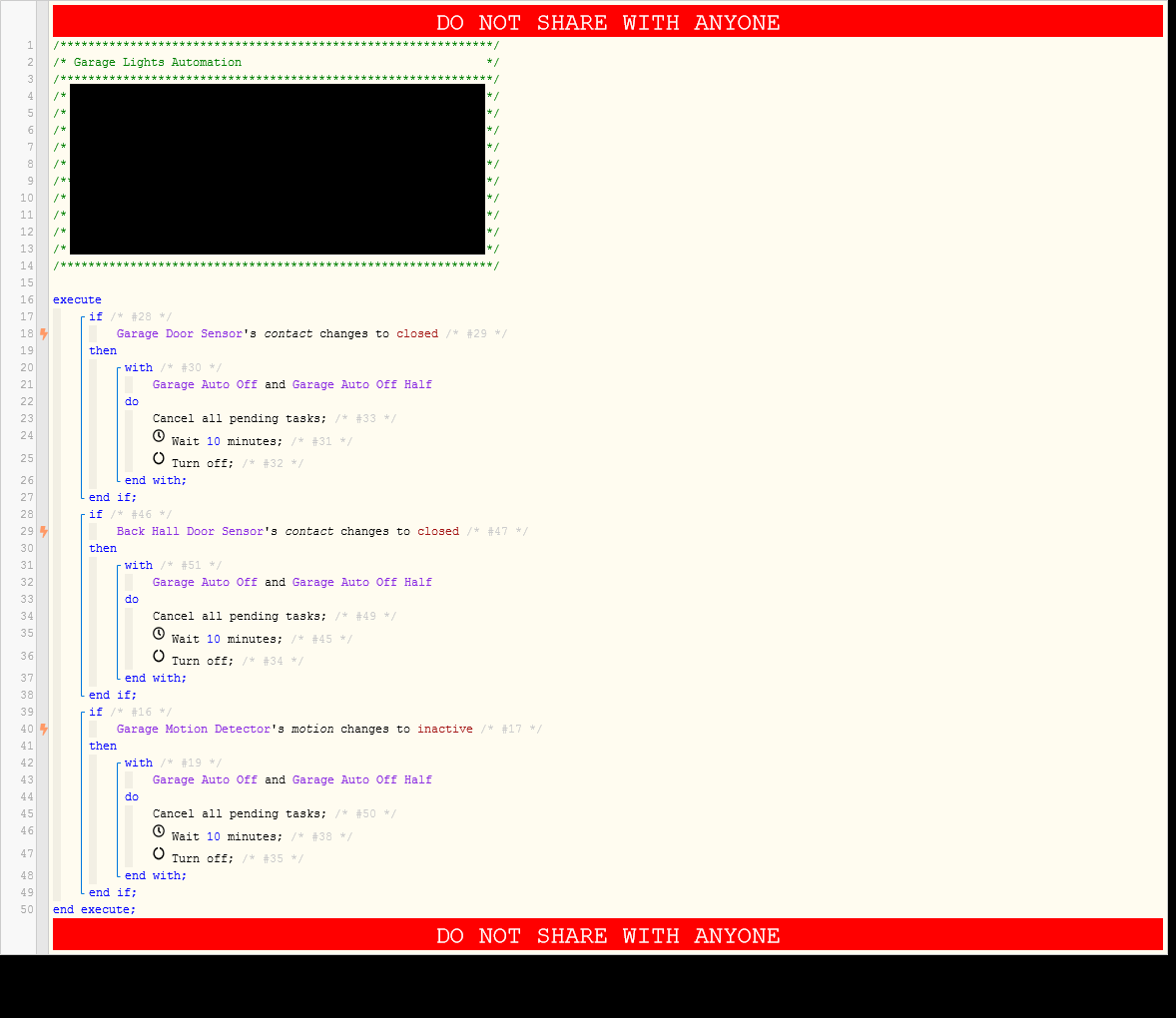

- Garage Lights Automation.
a. This piston controls the OFF of the garage lights.
b. This piston uses the buttons instead of the actual lights.
c. This piston uses the “Cancel all pending tasks” to interrupt the timing of other doors/motion.
d. These three separate IF statements use to be part of each piston above. I moved them into one because I use to be left in the dark in the garage at night. That’s because one of the timers would always run out, even if another “ON” event happened.

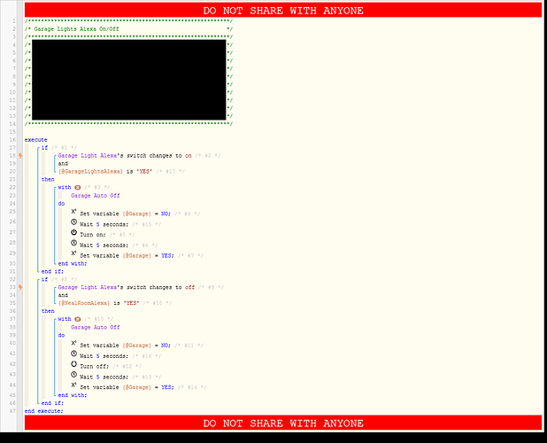

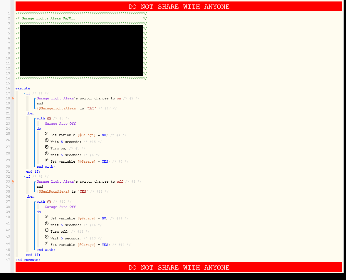

- Garage Lights Alexa On/Off.
a. “Garage Lights Alexa” is an On/Off Button Tile. In the Alexa App, I changed the Type to “Light”. The reason for this is, when I tell Alexa to turn on the lights in the garage, this fake “Light” also turns on. This turns the On/Off Button Tiles on ActionTiles to represent the lights being on or off. I keep this fake light in sync with the real lights. There are future plans for this.
b. This piston is used when Alexa turns on/off the lights in the garage. It uses the fake “Light” mention above.

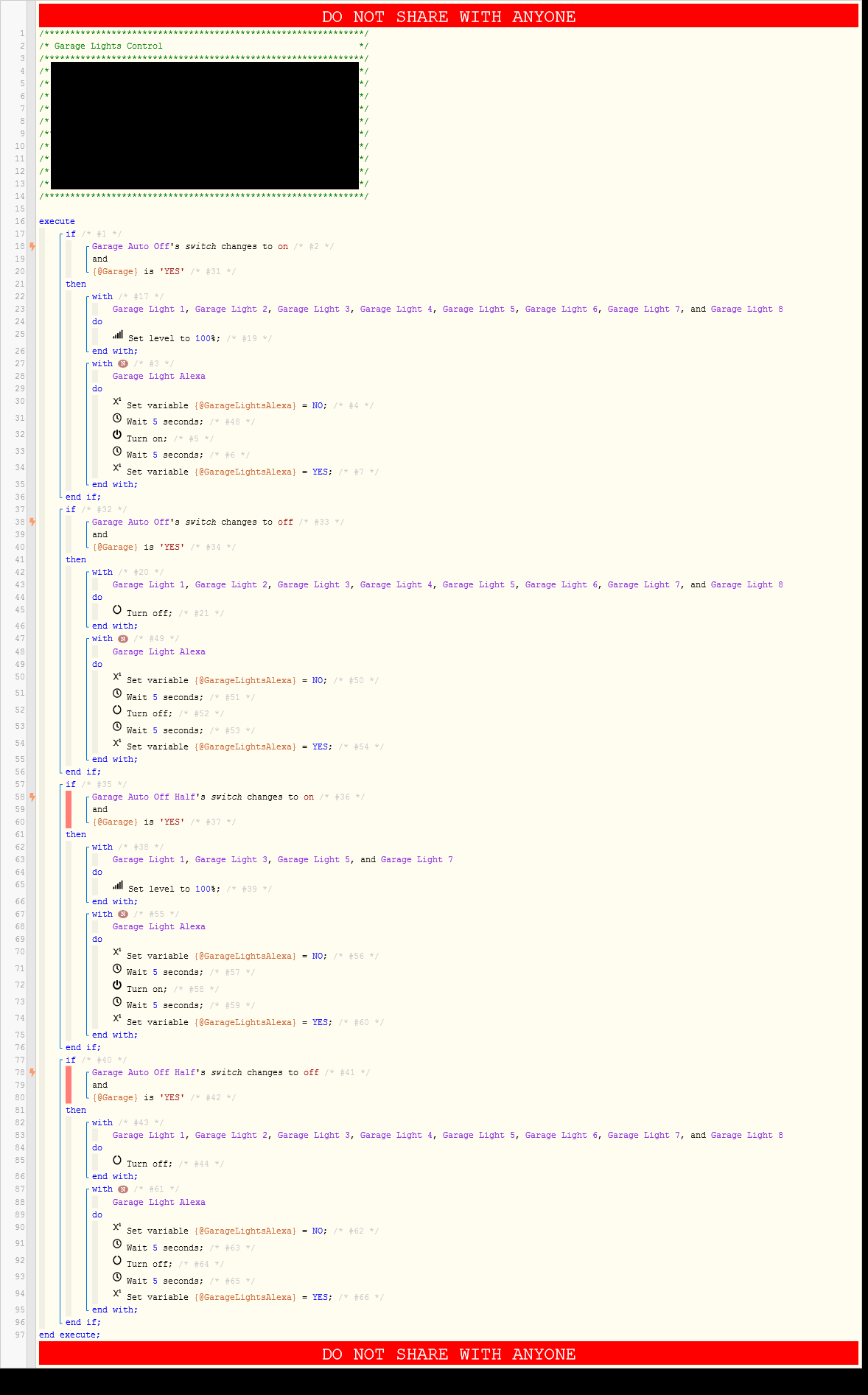

- Garage Lights Control.
a. This piston brings the buttons, fake light and variables together from the other pistons.
Adding my Garage Panel from ActionTiles, to tie it all together:
