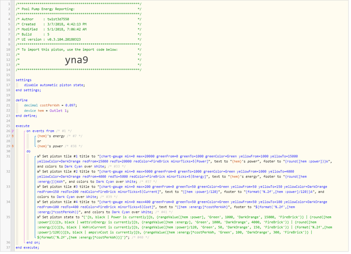

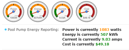

I want to make the “Current Cost” to stop on a certain day to mirror when my “month” is over (when power meter is read) and also keep a rolling cost for annual usage/cost. I borrowed this piston from the examples page and it has worked great so far.

Not really. The cost is the highest cost on the cost schedule and it is coded here:
at just under .10¢ a KWH.
The amount of Power that it has consumed so far since I started using this piston is:
When the pump is running it shows the amp load here:

"This Months energy (so far) is X " which is currently displayed as image

Finally, “Annual Total Energy Cost” Which this will do if left alone image but this will need to reset on December 20 of each year. Because that is the end of Georgia Power Companys billing year. The Billing cycle runs to the 20th of every month.

Here is what the whole Piston looks like while the pump is running:

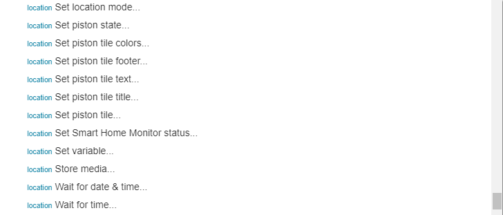

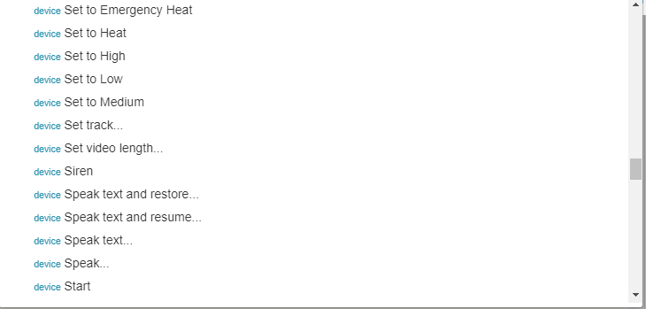

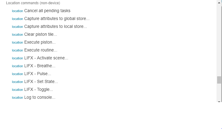

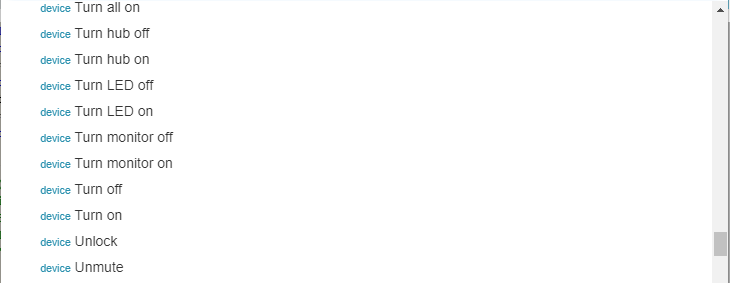

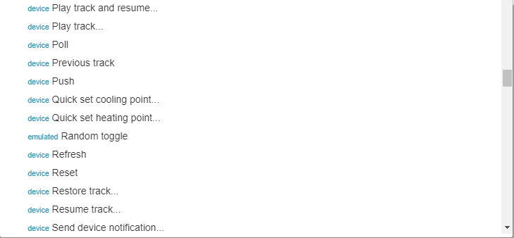

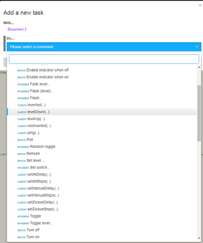

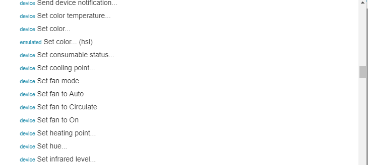

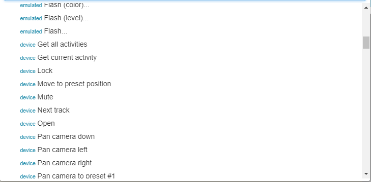

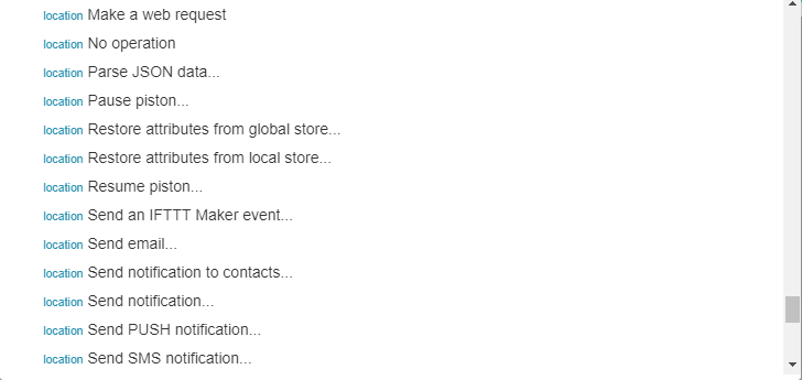

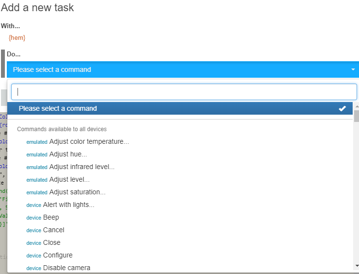

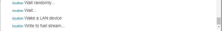

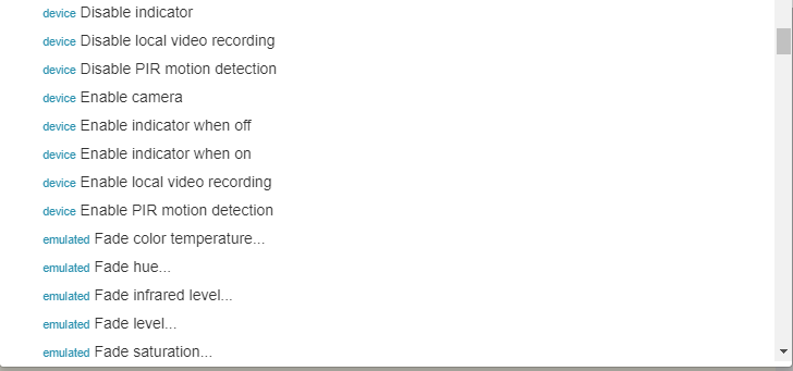

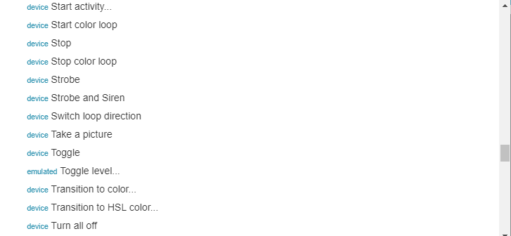

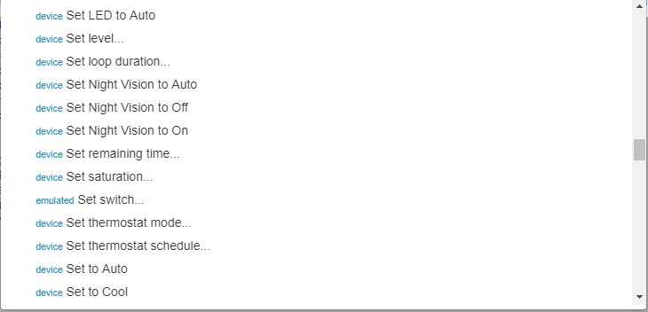

Can you do me a favor and go to the box where you can select actions with your HEM, click on the dropdown list, and let me see what’s available on there? For example, with a switch:
Not sure where to get that information. The only Do’s are with Location.

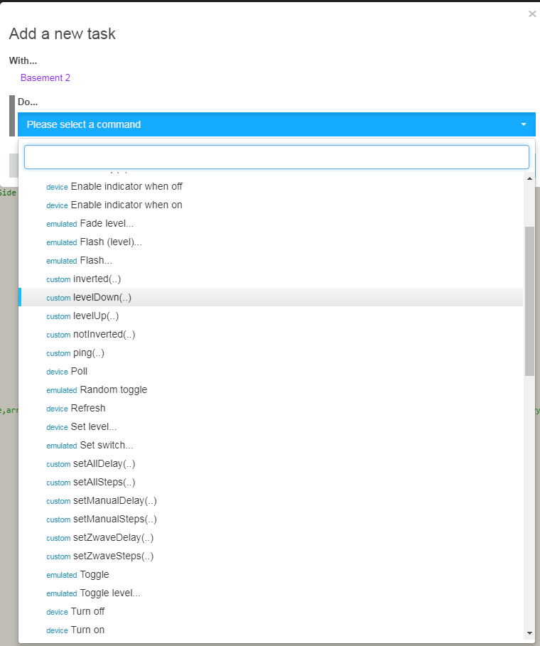

Can you select your HEM from that first drop down list, click add task, then see what is available? That’s what I wanted to see.
Unless someone with an HEM can post up how they reset consumption. There has to be a way.
Ok, later tonight I’ll post something up that stores your work energy consumption daily and gives you a monthly summary.
Someone with a hem will need to let us know how you reset consumption though. It has to be possible.

Working on this now and after importing, the first thing I realized is your hem is actually Outlet 1. Can you try the same thing we did before to list the tasks, but select whatever device is you “outlet 1” in the sample piston you posted? I’d like to see what actions are available for it.

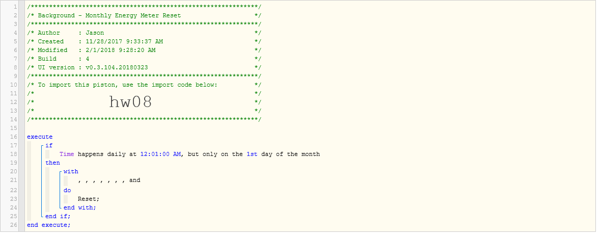

It’s not for a hem, but a couple different styles of aeotec. I have a simple monthly reset for my Grafana energy graphs. Resets at the end of every month. Could easily re-populate variables at the same time. Just curious if the hem works the same way as this energy meter capability.
My approach would be to capture the value for the last month and update the cumulative. The live cumulative value would be cumulativevariable + current value. Update the variables, then reset. Then your dashboard could should last months cost and total, cumulative cost.
