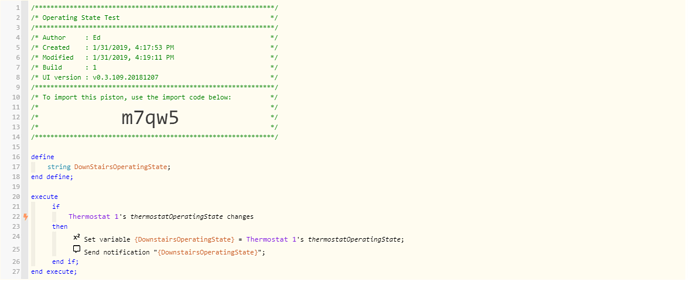

Piston is NOT triggered when thermostat state changes.
Piston should trigger when thermostat state changes.
Nothing is happening
I feel like I am missing something small/stupid. But I can post logs if you think that they will be helpful.

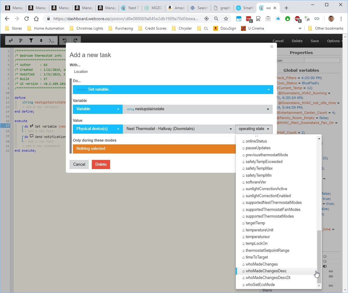

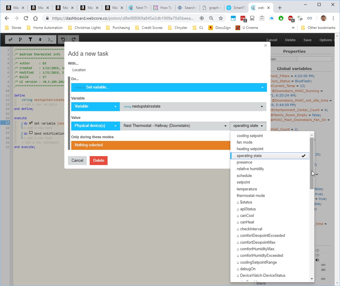

From what I have seen, most Device Handlers do not push attributes with a ‘house’ icon in front of them. (meaning they won’t work as a trigger) Although they can be queried to grab the current data.
Also, I think “operating state” might not be the same as “thermostatOperatingState”.
(you won’t find spaces in attributes with a ‘house’ icon)
I selected Operating State (no house). The green screenshot shows thermostatOperatingState.
