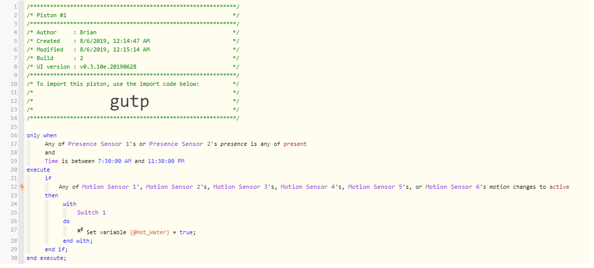

Does this look correct?
#29
looks like it:)
#30
Piston #1 gives a message “This piston does not subscribe to any events. Unless executed by other means, it will never run on its own.”
The piston never starts anything. What am I missing?
#31
I cannot get the sensors to not re-trigger the piston. Every time the sensors see motion, the piston starts over. I just need the first motion to trigger timers that cannot be restarted until the end, even if the sensors see motion during the piston.
