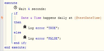

My earlier sample piston & statement is true:
… BUT… there is a loophole…

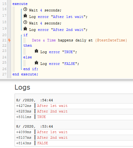

If we need to extend that 4 sec a bit, and still return true at the correct time, we can add another WAIT (up to 4 sec).
pic
I believe the total of all WAITS (plus processing time) should be 9 seconds or less for this to work. IE:
  • 4s WAIT times 1 will succeed at 4 seconds
  • 4s WAIT times 2 will succeed at 8 seconds
  • 4s WAIT times 3 will fail at 12 seconds
  • 4s WAIT times 4 will fail at 16 seconds… etc
Edited the last 4 lines to better clarify.
#22
So 8 seconds fails but 2 4s waits still works? Did you test 3 4s waits? That is very strange behavior.
#23
Not strange to me… A 4 second WAIT is a FAKE wait… (the piston just stays in limbo)
Doing a command, and then another WAIT at 4 sec gives the same success. (the piston does not stop)
A 6 second WAIT requires a wakeup (and failure)
If any piston ever goes past 10 sec (or 9 sec to play it safe), it also requires a wakeup (and failure).
