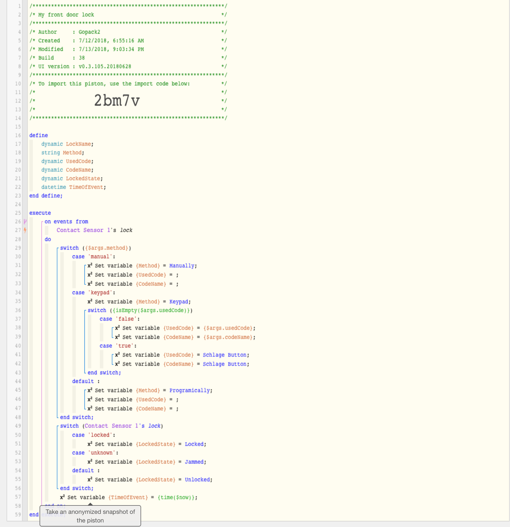

This seems to work as I intended. It only sets the variables and distinguishes how lock was interacted with. It doesn’t do any notifications or automations. That you can add as needed.

Yeah, for some reason, my locks only return manual unless I explicitly lock or unlock with a code.

Hello
When I lock my Schlage from the outside, I have those arguments
+140ms ║║[lockName:Porte Avant, method:manual]
When I unlock from the keypad, I have:
+139ms ║║[codeId:3, lockName:Porte Avant, method:keypad, usedCode:3]
When I lock manually from the inside I also have
Is there a way to know if the door was lock manually from the inside or the outside?
I would like to set my alarm correctly If we are in the house (at night) or leaving the house
Thanks!
#27
not that i am aware of… its manual, keycode number , or via app that i am aware of.
#28
for your information this is what I did
If my door is locked AND if my door sensor was open in the last 30 seconds, I set to away, otherwise I set it to night mode
working great so far
thanks
