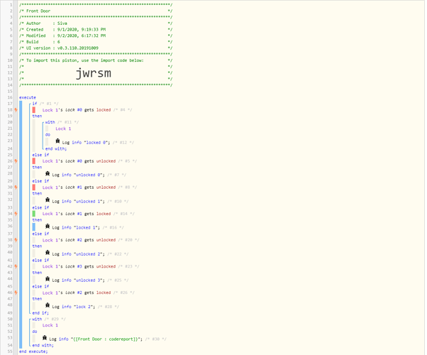

I have four codes programmed into my Z-Wave Plus lock BE469ZP. When I use any of the PIN the lock cannot identify the user with the PIN entered.
Is there a way for me to get the correct identifier?
  1. Dad - PIN - 1234 (when unlocked using PIN 1234 should be identified as #0
  2. Brother - PIN - 2468 (when unlocked using PIN 1234 should be identifed as #1
  3. Siva - PIN - 2268 (when unlocked using PIN 1234 should be identifed as #2
  4. Arun - PIN - 5268 (when unlocked using PIN 1234 should be identifed as #3
“Front Door’s Lock #3 gets unlocked” should return True when PIN 5268 pressed on the lock.
I get 0 or 1 when the lock is unlocked and the same when the lock is locked. No consistent result. I installed a device hander to see whether it resolves the problem. I deleted the lock and re-added to ST. I started the simulator on the ST “My device handler” and clicked on simulation and picked the physical lock (not virtual). I could see the correct indentifier on the log. I am sending you that log below as well. Is there a way for me to get the correct identifier?

If I am understanding your piston correctly, then why not eliminate all of the ELSE statements and make all of your statements IF statements…
IF lock 1's lock #0 gets locked
    Do Stuff
IF lock 1's lock #0 gets unlocked
  THEN
    Do Stuff
Nested Else statements can get messy and difficult to debug.
I would take a few minutes and read some of the other posts here on Schlage locks.
(This post, as well as a few others)
The issue here is I am not able to find who has arrived home by using the PIN. The Webgate event (see snapshot) reports 0, 1 or 2 but doesn’t seem to follow a logic. I cannot say 0 mean PIN 1234 (DAD) or 1 mean PIN 2468 (Brother). It is only accurate enough to say the door is locked or unlocked. I could see the ST device handler receive the correct consistant identifier but the webgate doesn’t seem to get it. Any help is appreciated.
Thank you, Please let me know if you need anything. ST device handler log shows (debug) code 4 and code 2. But webgate is getting valve 1 without any pattern or logic.

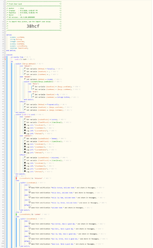

The first link above shows you how to parse that number, so you can do different things depending on what it is.
Some of the 2nd link demonstrates alternative versions of this.
WCmore. Thanks for your quick reply. You Nailed it. I am able to identify the user by the PIN number entered. The Structure on the 2nd link is perfect. I built on top of it. I corrected a few things based on my requirement.
. This works for Schlage Lock users from Canada. ST app seem to be different for customers from USA and Canada. ST tech support didn’t help us but webcore did. I will make a donation for WebCore soon…
