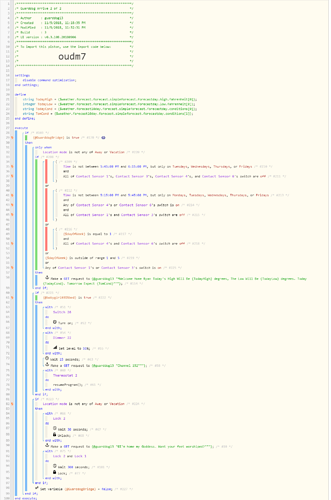

Seriously Can No One Help Me?!?! This is getting Frustrating

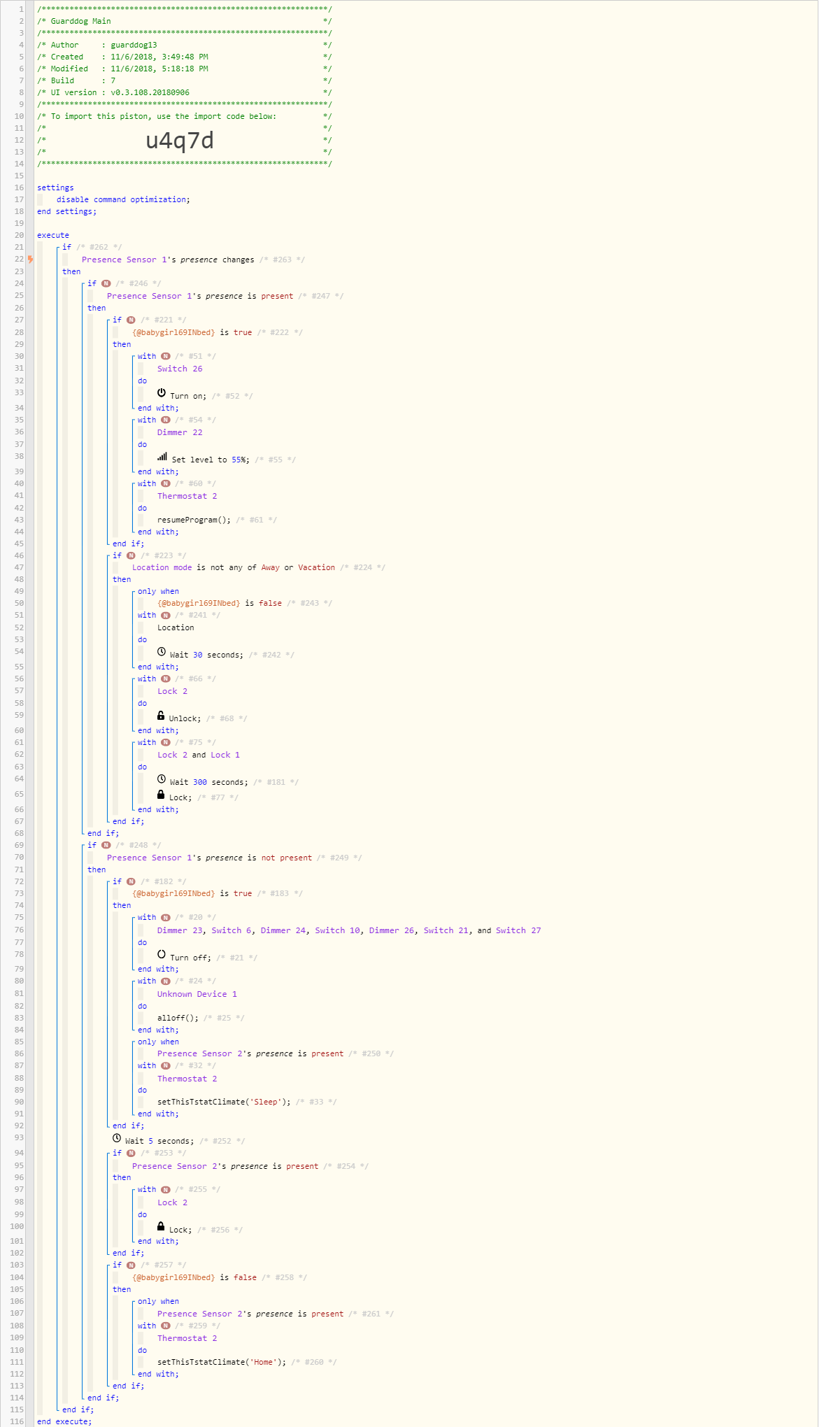

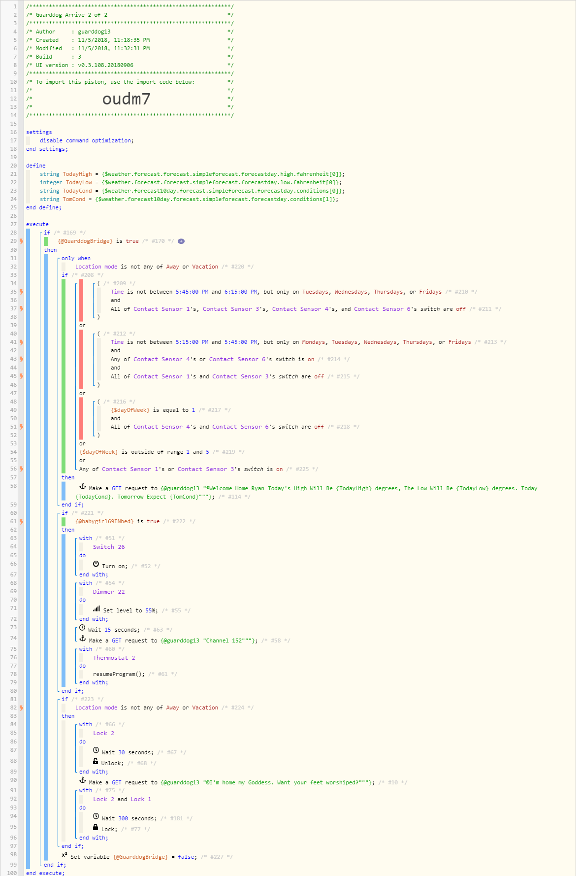

I moved them all to is present then put them in ifs. i ran a test via the piston with trace on. The door tried to unlock twice before it ever got to the command to unlock the door lol.
Thank you all so much for your help. For weeks I’ve banging my head against the wall over this. The problem was in one of my get requests i had @guarddog13 “MLBTV” instead of “MLBTV”"" That seems to have fixed the problem. I don’t know why but it’s had flawless tests since i fixed that.
Or not as i watch it loop through commands again. arg
If the locking aspect is the only thing not working on this long piston, why not isolate it by moving the two blocks into their own piston?
IF Presence sensor's presence is present
Wait 300 seconds
Lock Door
END IF
IF Presence sensor's presence is not present
Wait 5 seconds
Lock Door
END IF
Not only does this prevent any other activity from tripping the piston, but it also makes troubleshooting a breeze.
Also, at the risk of stating the obvious, while you are testing, make sure you have no other pistons/routines/scenes programmed to lock the door. (again for isolation purposes)
Its not just the lock the entire piston acts weird. When i trace it, its stopping at one of the get requests. it pends then turns red, counts up and sends several of the get requests over and over, then the Piston begins again.
its line 73. it fails right there every time.
