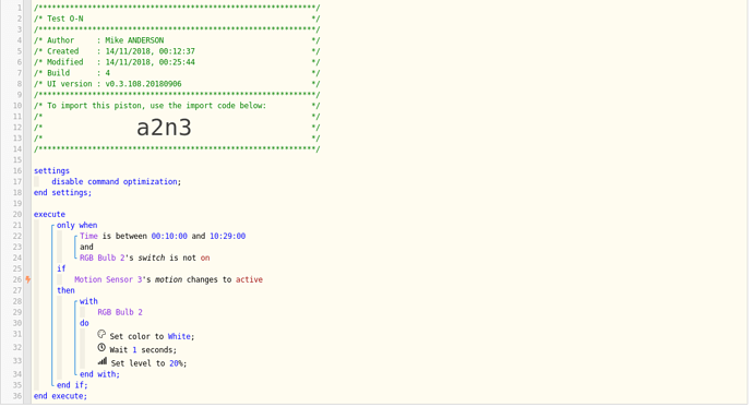

I think I have figured it out, I added a extra line to @allrak 's piston; If light is not on, turn it on.
It now appears to work. It still goes up to 100% and then down to 20%, however it just does it the once rather than every time the motion sensor, senses movement.
Here is the script:
#15
I have never noticed that the Color command also sends a level command. Thankfully, once the level has changed, it does not send the old level any longer.
Thanks for the update. I swear I learn something new about webCoRE every day!!

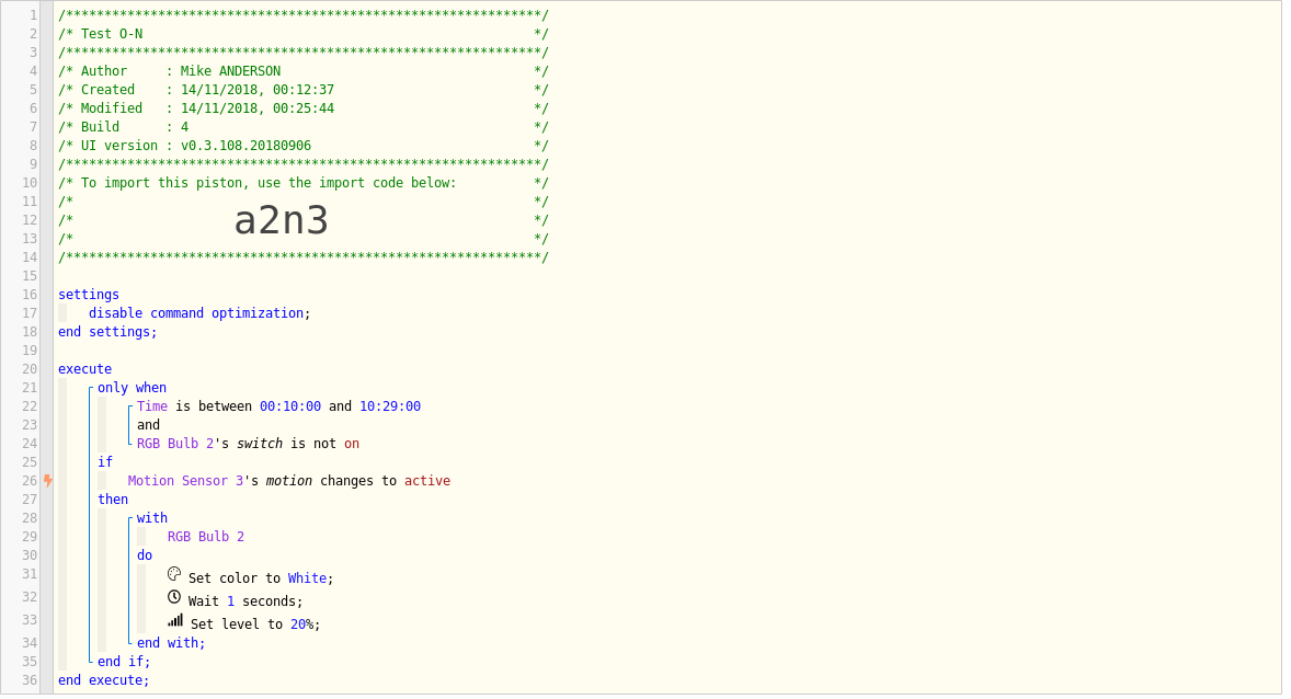

My hunch is if there is a 1 sec pause between it will not do that.
IE:
Set level to 20%
Wait 1 sec
Set Color to White
#18
Unfortunately not, the level starts at 20% and then goes to 100% where it stays
I’m thinking it is related to Set Colour command.
+167ms ║║Executed physical command [Couch Lamp].setLevel([20]) (11ms)
+168ms ║║Executed [Couch Lamp].setLevel (13ms)
+172ms ║║Executed virtual command [Couch Lamp].wait (1ms)
+173ms ║║Waiting for 1000ms
+1188ms ║║Executed physical command [Couch Lamp].setColor([[hex: #FFFFFF, hue:0, saturation:0, level:100]]) (10ms)
I have a solution which is great, the light will only turn to 100% once when it is turned on. I would like to think there is a technical reason as to why the bulb has to set to 100%, but its frustrating when all I want to do is set the colour.
