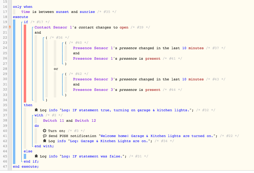

So with this code, Presence Sensor 3 (the Android phone) came home tonight:
Logs:

It failed this time again to achieve what I wanted but I noticed that his sensor actually didn’t change state from “away” to “home” until 11:54pm according to the ST app. That’s after the Garage Door (Contact Sensor 1) open/close had happened (according to the logs above), which is really odd. I wonder if it has something to do with the Android phone’s location update being slow.
I will keep the code as is for now and see if it’ll repro the next time and see if Presence Sensor 1 (the iPhone) will have this issue.
