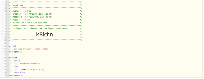

text is intercepted, but kioskbrowser keeps saying “null” instead of the actual text. I’m obviously not setting the argument correctly.
the tasker part is currently:
1. variable set
name %status To %antext
2. variable set
name %pistonURL to https://xxxxx
3. httpget
serverport %pistonURL?status=%status
(unknown device is kioskbrowser… not that it seems relevant.

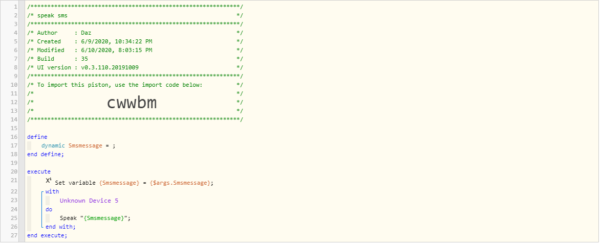

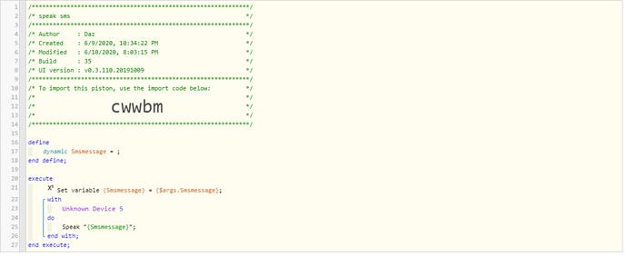

And my piston:
Cheers all!
Lookin’ good!
It should be easy to add now that the core concept is working…
Just be careful if you add any conditions, because they are treated as triggers by default.
