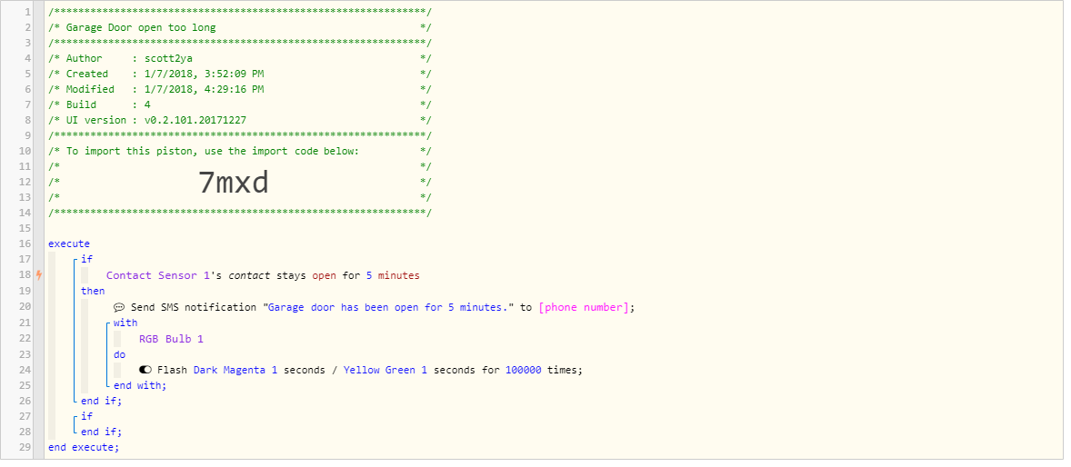

Some complicated stuff. I was able to get the text message set up haven’t figured out how to get it to flash one of my lights… gonna keep working on it
not sure how to stop the light from flashing… basically I want it to flash indefinitely, until the garage door closes. But not sure how to get that in there. Idea?
can’t get the ligth to stop blinking unless I manually do it. Idea’s? I changed the time to 10 seconds while I test this thing…
Yeah, you want a “While” loop. And because I know the next problem you’ll run into I coded for that as well. I’m guessing you don’t want the light to stay at one of those colors the next time you use it. So I capture the current state of the light and then put it back to how it was. There’s a Wait command at the end which may or may not be needed…depends on how fast your lights get and set the command to restore. Mess around with that and see. Also you can lose the Debug statements once you verify this is working (just delete them).

Well, after a little more testing, it leaves the light on maybe 40% of the time. Any adjustments that I can make? I’d be fine with turning the light off when the garage door closes, even if the light was previously turned on, that would be fine. This light is mainly just a light to notify people in the house that something is going on.
I tried changing the delay at the end to 3 seconds, but that doesn’t seem to matter. I’ve noticed that while my light is red, if I close the switch, (I took it off the garage door and have it next to me while testing), it almost always will leave the light on. bright white, never red, when complete. If I close the light while it’s white, it usually will turn the light off at the end when I close the switch.

Alright, well this was a bit of a learning experience. After finally being able to reproduce the behavior that you were seeing it became clear to me that the piston was running itself multiple times. This was in large part due to the ridiculously small test time values that we’ve got in it right now (seconds instead of minutes). So every 2 seconds it would fire off again. That’s what was messing with the lights going back correct at the end. So I’ve made some significant changes at the top in order to try and prevent that from happening…and I believe when you plug in your real time values that this will all just work. I did have it working here though with the values that are in place now in this piston. The last condition “previousAge” is basically a time based lockout so that this thing cannot run itself again within a given amount of time. Right now it’s set for 30 seconds, but you’ll probably want to crank that up as well when you fully deploy it just to be safe. It’s a value in milliseconds, so if you want a 10 minute timeout that would be 600000.
Give this one a go, hopefully I’ve got it all sorted now. If not, well, we may have to get some of the minions to come in and assist…but hopefully that won’t be necessary.

So the very first time I ran it it left the light on green. I might have closed the switch too soon. I’ve ran it at least 10 times afterwards and it’s worked perfectly every time.
