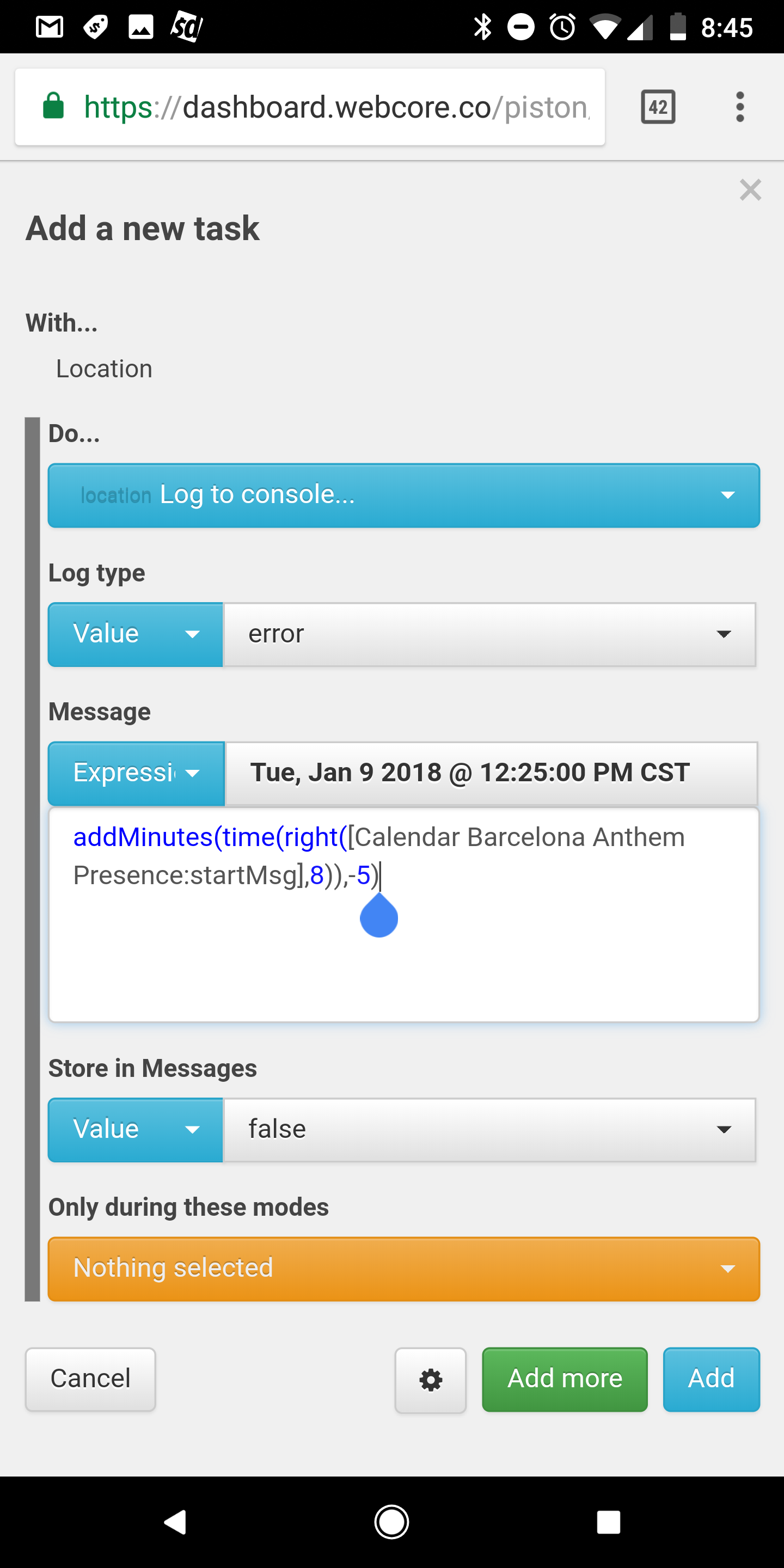

Trigger an action 5 minutes before "GCal Search" event
Typically any standard date/time format would work. But randomly stuck in a message probably won’t do it.
I’m going to refer to the entire expression you have above as $data just for simplicity.
Try this
addMinutes(time($data), -5)
Instead of trimming the last one by 15 can you just wrap it in another time() function?
The original intent was to trigger an alert 5 minutes before correct?
You can do a time happens daily (under virtual devices/time) and then change the value field to expression and plug the above in.
I wanted to play a notification on speakers 5 minutes before the event. Is it normal to see the random number here? Thanks for all of your help by the way. All this is new to me.
That is just the converted time in milliseconds.
