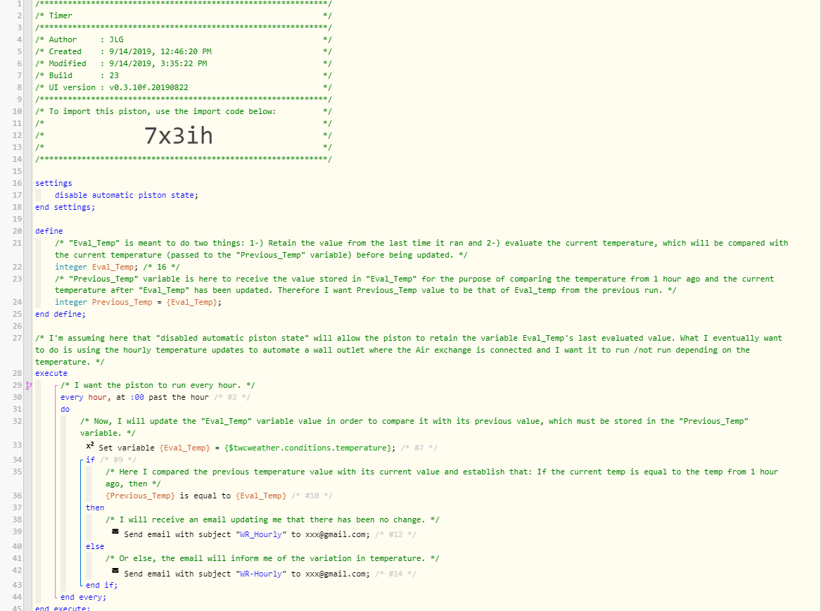

I am trying to create a piston that will control a wall outlet based on the outdoor local temperature provided by the weather channel ($twcweather.) For now, it is simpler to just receive an email notification, while I design the piston. With settings “disable automatic piston state” (though I also tried with automatic state enabled), I created 2 variables: one (Eval_Temp) to retain the value from the previous time the piston ran and also to be updated every time the piston runs; and a second variable (Previous_Temp) whose default value in the “define” block is equal to that of the first variable (Eval_Temp). Then, before adding the IF block, I set the variable Eval_Temp to the current temperature by having it evaluate $twcweather.conditions.temperature and then in the If block I compare the values of both variables.
I want the piston to turn the outlet OFF if the temperature drops below -30C and ON when the temp goes up over -30C and I want it to be updated hourly. For the purpose of testing the piston now, I just want the piston to send me an email with a particular TEXT every hour if the temperature changes or with a different TEXT if the temperature does not change (in the future, I want it to do nothing if the temperature remains unchanged or does not go up).
Not sure, either the current value is not updating or I have a bad code. I am new to this though.

I cannot dig into your code right now, but as far as this:
You should be aware that there is a daily limit on the number of emails we can receive from pistons. Anything beyond that limit is lost forever.
I would use either SMS, voice alerts, or log to consoles for testing
I don’t think email receive works
see:
and
Sending an email to webCoRE to be treated as a trigger is not functional at the moment… but webCoRE can send out emails just fine… Just keep in mind that there is a strict daily limit, so I only use those very very infrequently.
Logs to console is the quickest and most helpful way when I am in my testing phase… unless I need to be away from my desk during the test… Then I may use voice alerts or SMS
Thank you all for your answers. I finally got the piston to work according to my wishes.
