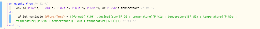

I did something like this the other day - up to the point of creating/setting the global variable - I’ll use it later. However, quick question…I used the format(’%.0f statement, and in the expression it prints nice as a whole number (image 1 below). However in the Variables output below the code window it prints a very long decimal (image 2). Should I be worried about that?
I’d suggest setting the value of your @PorchTemp variable to the output of your Expression.
That is actually exactly what I am doing here.
The first image above with the expression is the expression in this ‘set variable’ statement.
a) Your approach = Much cleaner! Nice
b) It seems to have self-corrected. When I went back to change it to use avg instead of sum/divide it was right, and when I average the sensors myself I get a 52.5, where now both the expression and the global = 53.
Thanks for helping.

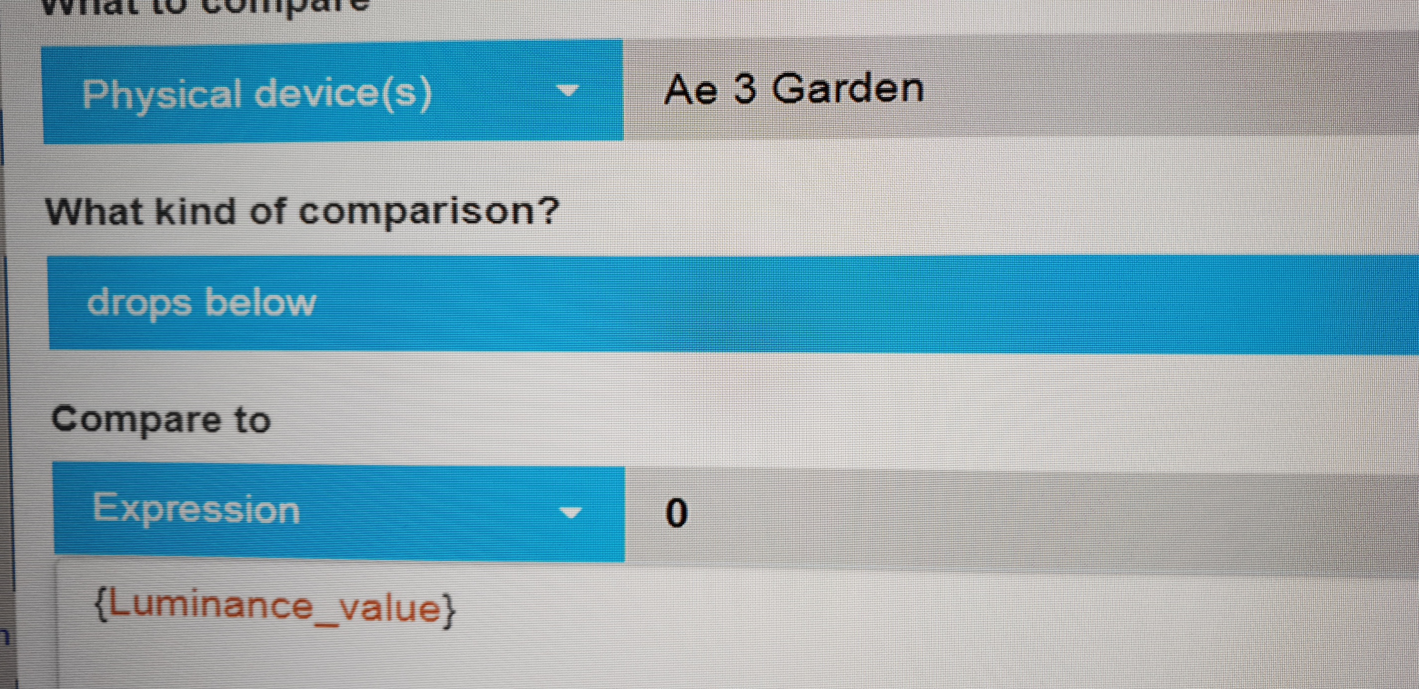

Maybe someone can help me here. All I’m trying to do is turn on a light when Lux reaches 0.16 say.
But i can’t for the life of me put
“If Lux drops below 0.16” because the piston can’t seem to accept a decimal…
I’ve tried using an Expression, but it rounds 0.16 to Zero for some reason.
what’s the trick?
No, actually it’s the custom zigbee module designed by Iman, and he’s made Lux decimal in the DTH. I think it helps with the Smart Lighting App maybe. Anyway i’m just trying to do a sunset piston for a light, using Lux instead of time.
Any idea how and I can trigger at 0.16 Lux?!!
I’ve made a variable called “Lux” that is a Number (decimal) with a value of 0.16.
But the piston doesn’t show it, when i say if Luminance sensor drops below variable “Lux”.
The variable “Lux” isn’t available from the drop down menu…
I always thought webCoRE didn’t accept decimals too but it seems to be a bug issue because if you copy and paste them into webCoRE they’ll work fine.
I used expression to convert the device:illuminance to decimal before it let me choose the lux variable.
decimal([device:illuminance])
