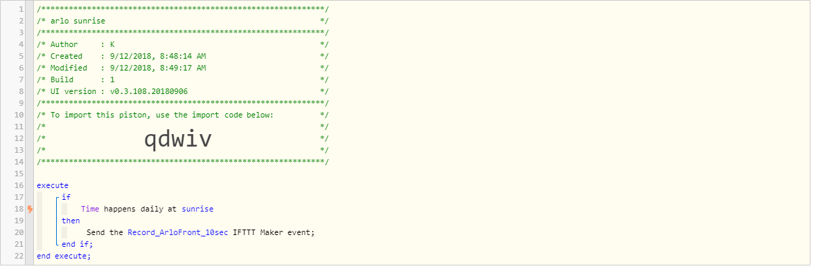

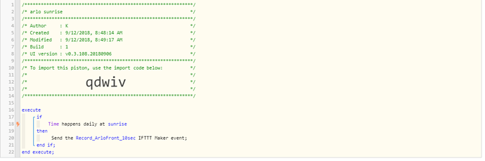

piston triggers sunrise twice
one sun, one sunrise per day
causes arlo ifttt to record twice
