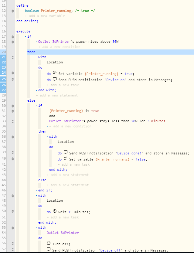

Piston send push notifications every time power rises over 30W which means that I get way too many push messages.
Device is 3d printer. When it is on it uses fans and power is something between 11W - 200W but mostly 15W. When nozzle and bed heats up it takes anything between 50W to 300W. When printing starts it takes mostly 50W to 300W but occationally drops even 0.45W. Devices power usage is so complicated that I have hard time to understand how to create piston that works.
I would like to have just one message when power rises over 30W for the first time. This should happen when printer is on and using its fans. When print is ready it should send “done” message.
It sends multiple messages.
