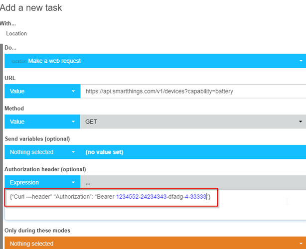

1) Give a description of the problem
I continue to get a 401 Error after setting up Personal Access Token
2) What is the expected behaviour?
It should bring back this information
3) What is happening/not happening?
When I run a test…
4) Post a Green Snapshot of the pistonimage
5) Attach logs after turning logging level to Full
REMOVE BELOW AFTER READING
How do I get this to work
In postman it comes back perfect, but I know the issue is either how I am setting up the header or I am missing something else.
Any guidance would be much appreciated.
Thank you.
Jared
#2
You might want to block out your token in the third screenshot
I have never used webcore to call the ST api but for another API I use, the curly brackets need to be sent as text. Try escaping them with \, webcore will treat as an expression otherwise.
Also not sure you need the curl header portion…only authorization and token
Example from one of my pistons
\{ "TOKEN_AUTH" : "{authtoken}" \}
obviously not for the ST api, different headers but you get the idea_
#3
You need to send a header of the form
Authorization: Bearer TOKENUUID
The Authorization: bit is being taken care of by webCoRE so it wants you to tell it the other bit. I usually do it as an expression because I tend to use a variable for the token, but the equivalent as an expression without a variable is
"Bearer TOKENUUID"
#4
That worked - Thank you so much.
