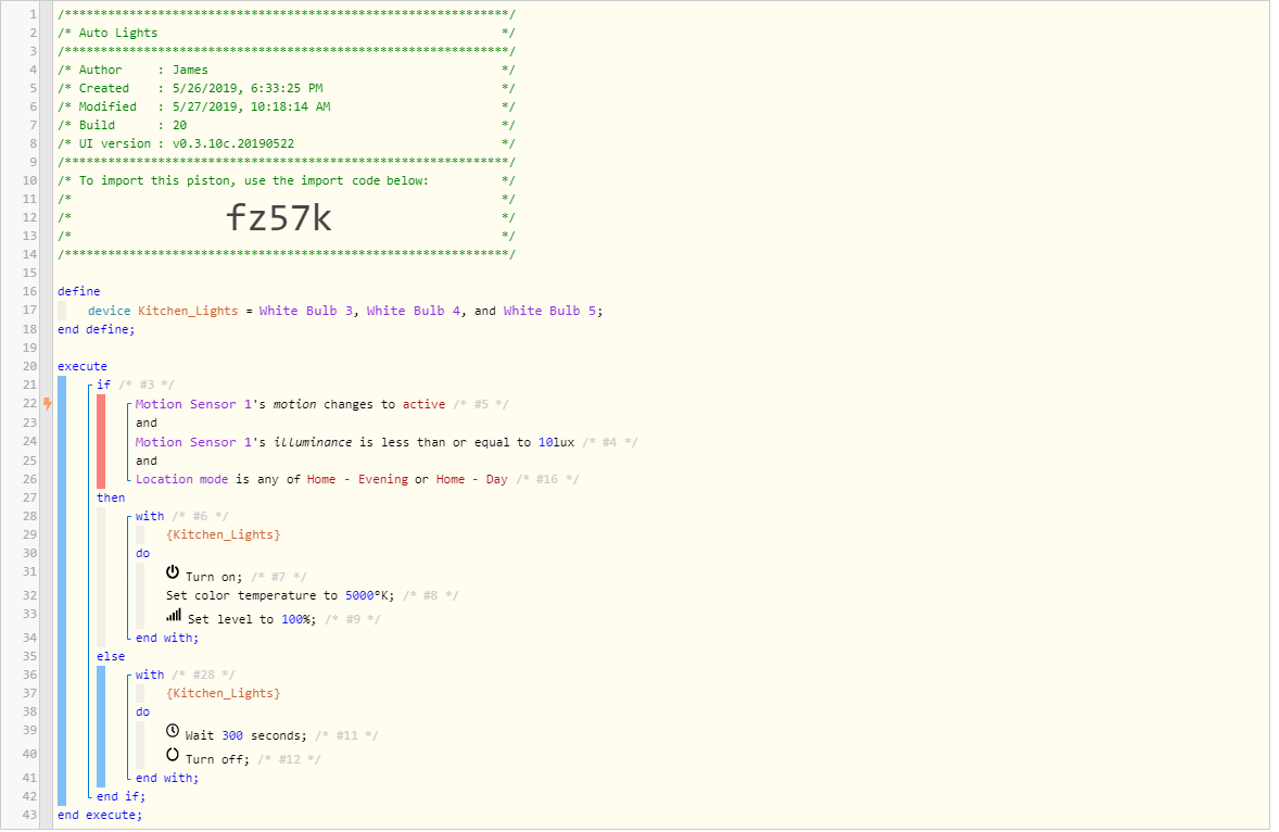

A Noob with "Wait" function issues

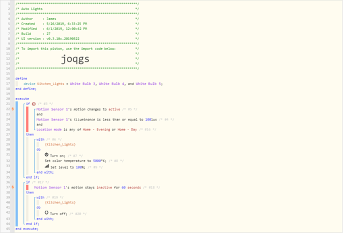

I am trying to get a basic light on, wait, turn off but it seems to be having issues. I previously had a similar piston working but managed to delete it. As I did having one working, im pretty sure i have done everything correct.
Some help or advice on this would be greatly appreciated and could you guy possibly explain any suggested changes in the piston to help a Noobie learn for next time.
When motion is detected when the light level and loctation mode is correct I expect the selected lights to turn on. Then, after 5min the lights should turn off.
The piston is working up until the “wait” bit. When I “Trace” the piston, i see the timer count down to zero, it changes to say “pending” then the timer next to the wait function starts counting up and the lights stay on indefinitely. The other confusing issue is that sometimes the piston actually works! Looking at the log it seems as if the timer (that show next the the “wait” function when Trace is checked) counts up to 3-4min and then the piston restarts and the 5min/300sec countdown begins again.

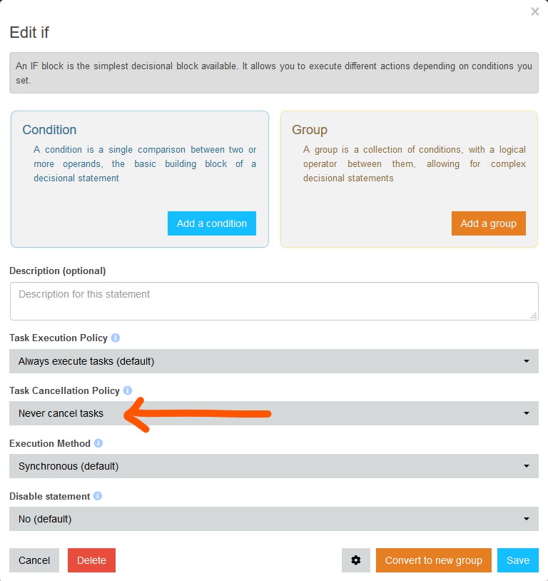

I have not tested it, but I suspect you need to set your Task Cancellation Policy of your IF to Never Cancel. I suspect your Wait is long enough to allow your motion sensor to reset. That cancels your piston execution and restarts from the beginning because the “trigger” state has changed.
Thanks @Pantheon for the suggestion however it doesn’t look like it has resolved the issue. I also tried the No Task Cancellation Policy on the “With” statement only, and also the “If” and "with together with no success.

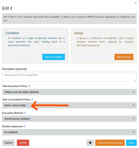

Ok, my fault. I did not read your post correctly the first time. As I understand it, you want to do the following :
and illuminance is low (it’s dark)
and location mode is Home - Evening or Home - Day
Turn on the Kitchen Lights
Set the color to 5000
Set the level to 100%
Then you want to wait 5 minutes and turn Kitchen Lights off. Is that correct?
If so, then move everything from your ELSE statement into the THEN statement :
IF motion_1 motion changes to active
     and illuminance is less than or equal to 10
     and Location mode is Home - Evening or Home - Day
     With Kitchen_Lights
	Turn ON
	Set color to 5000
	Set level to 100%
	Wait 300 seconds
	Turn OFF
You will still need to set your Task Cancellation Policy to Never Cancel.

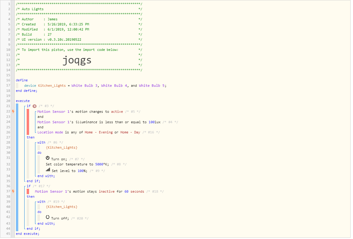

If that works for you, then you may want to give things a little more thought. Let’s say you walk into the kitchen and the lights turn on as desired. And then you leave. If you walk back into the Kitchen 4 minutes and 59 seconds later, the lights will turn off and may not turn back on.
One way to address that problem is :
     With Kitchen_Lights
	Turn ON
	Set color to 5000
	Set level to 100%
END IF
IF motion_1  motion stays inactive for 5 minutes
Turn Kitchen Lights Off
END IF
I gave the “Wait” function another go and it was hit and miss to whether it worked or not so, i tried your other suggestion of “inactive for Xmins then”. Again this was hit and miss. I set the time for 1min for testing. You can see in the log that a full 10mins of inactivity went past until the lights turned off.

Hmmm…This tells me that your motion sensor is still active in the second IF and therefore the OFF gets cancelled. I wonder if you change the Task Cancellation Policy back to default (since you don’t have a WAIT) if that will allow your lights to turn off after 5 minutes.
@WCmore?
Your latest piston (joqgs) looks good to me… I would not change a thing with that one…
According to the log, webCoRE did what it was programmed to.
12:04:21 PM = Received event [Hue Motion Sensor (Hall)].motion = inactive
12:04:21 PM = Setting up scheduled job for 12:05:21 PM (in 60s)
It seems like something was bogging down your system at 12:05. After ten minutes, webCoRE’s recovery kicked in.
12:14:48 PM = Received event [Home].execute = recovery
This makes me think that you have other pistons/programming looping, and the ST hub was overwhelmed at the time…
If there is too much commotion, sometimes commands will get lost in the ethers…
(kind of like packet losses)
This might have something in it, i have only 3 active pistons however, i have another 3 or 4 “Test” Pistons paused. Is it possible that they are interfering with the active ones?
Thinking about it, i had trouble installing the latest update, could it be that i have somehow got two versions of WebCoRE installed and running together? How would i check this? In Smartthings Classic I only have one WebCoRE smart app displayed but could the be running tin the background?
The number of pistons doesn’t really matter. (I have 396 pistons in my house. Maybe half are paused) Any pistons that are paused will not execute.
What matters is what is happening at the time of execution. It could be another piston looping. It could be another automation in process (ST Routine etc). It could even be heavy internet traffic at the time. For example, when I am bittorrenting, my pistons drop to only 90% reliable.
Hi there just a quick update… I decided to completely start from scratch with regards to uninstall webcore and factory reset the ST Hub. (not as drastic as it sounds lol. I have only been trying to learn this for less than a month so only i had 2 pistons and all my devices import from my Hue Bridge). Now everything is running again i have found that the piston is working as expected as it is setup in the “joqgs” piston. It sometimes lags but it must be a cloud based lag as i have minimal internet traffic.
Thanks for the help and suggestions @Pantheon and @WCmore. It is good to know that there wasn’t anything major wrong with the piston. :smile::+1:
