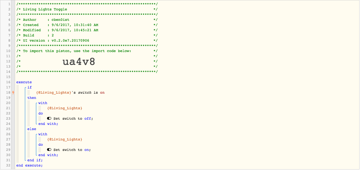

I have x lights in a room and I created a virtual master switch to turn on/off all of them from that switch (Master switch used in homebridge and actiontiles fr example). My list of lights is in a global variable and I created a piston where if any of the light of the list is on then turn everything off otherwise turn everything on… Indeed I entered an infinite loop since that piston is triggered as soon as 1 of these lights changes of state…
So I want this piston to be only executable from another piston and not from a device change of state.
Am I doing this completely wrong ?
Any help is appreciated and sorry if that’s a dumb question.
Thank you

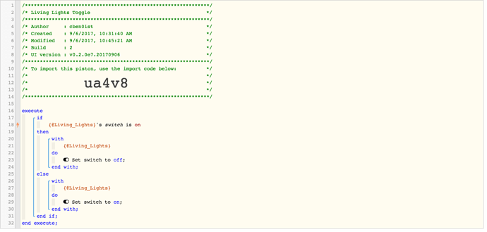

My very basic “toggle” piston I want to call from other pistons only:
If I understand your question, you want a piston to only execute if it is called from another piston? In your toggle piston above, open the cog in the IF statement and unsubscribe from the switch. Then when you save the piston you should get the following message
This piston does not subscribe to any events. Unless executed by other means, it will never run on its own.
Then your piston will only run if it is called from another piston.
