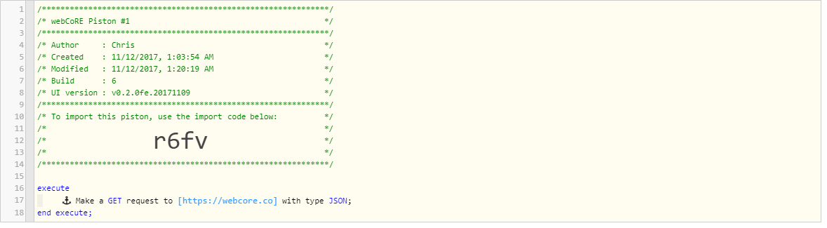

I am trying to perform a GET request to googles API
a 200, with the data returned accessible through pistons
I am receiving an error stating that the endpoint is blocked.
