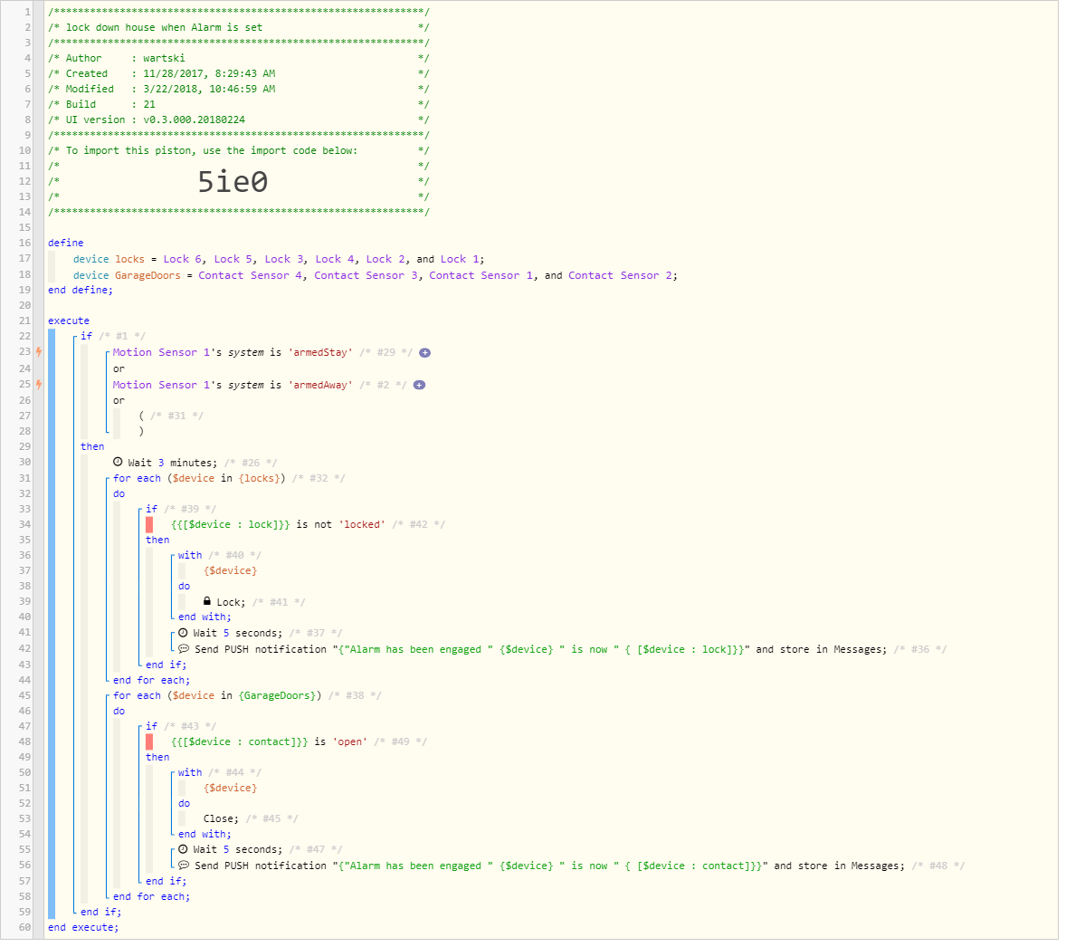

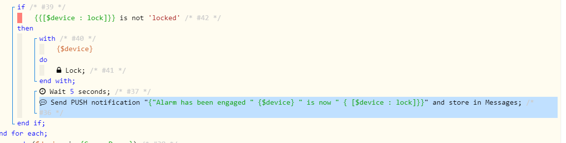

I’m having a problem with this piston where I’m not sure if it is firing or not. I have a trace, but would like to push some notifications to show whether locks are being locked when alarm set. Some of which are not being locked for some reason.
Do I have the correct variable to show the lock status of each lock?
