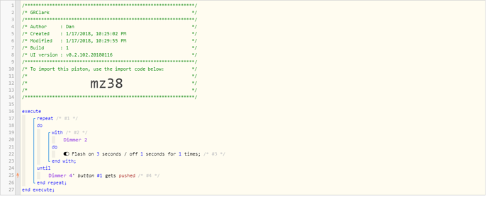

Not sure where to begin by how can you make an action continue until there’s a physical stop to the action - i.e. siren continues until pushing stop button, lifts flash until turning off? Does it require a special statement?
Action continues until physically stopping

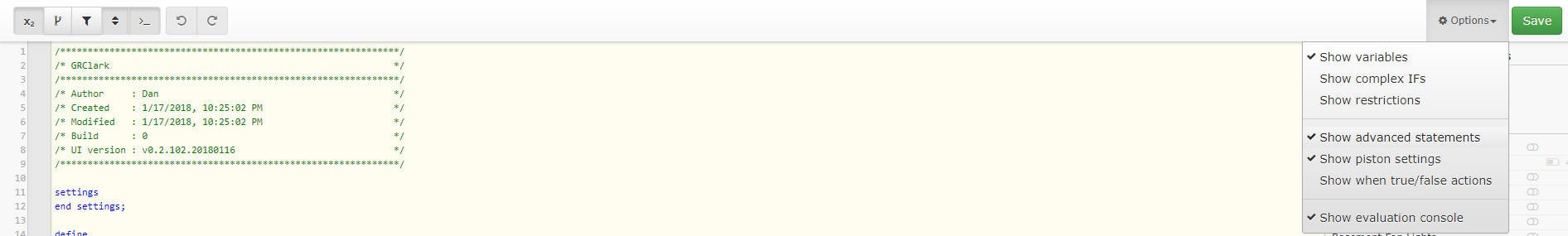

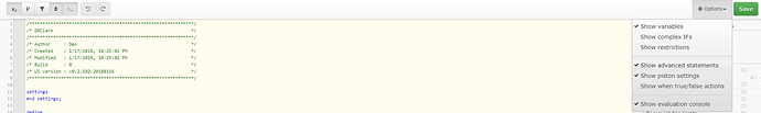

To find things along those lines, enable advanced statements when you’re editing your piston:

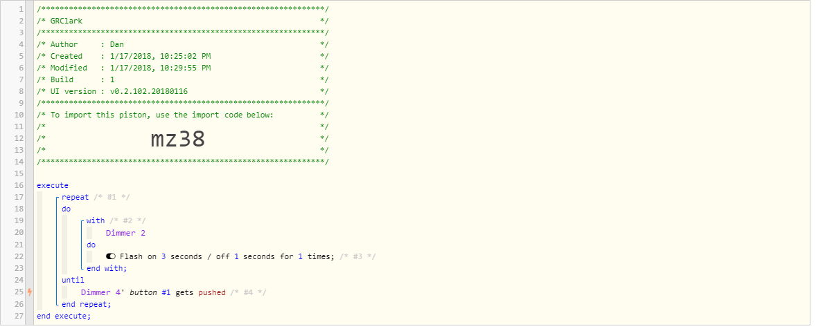

Then you can do something like this:
