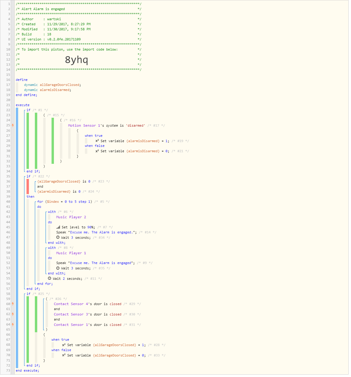

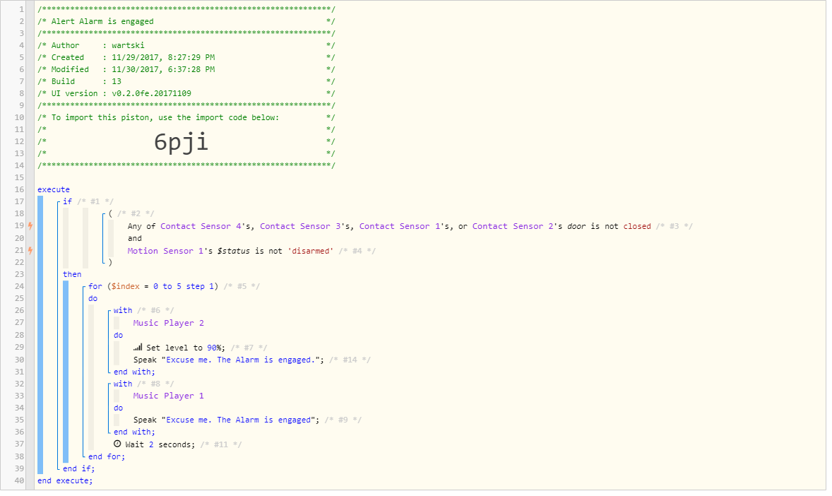

Action doesnt tirgger
the action is not triggering
Expecting the TTS music player to speak (and I know this portion works).
Seems like the conditional AND function is not working as I expect it to.

$status is a made up variable about the status of the device in SmartThings eyes. IE it is responding so it’s online or it hasn’t been heard from in awhile so it’s probably offline.
Don’t know what the “motion sensor” is but instead of evaluating the variable check the preset value list for what you are looking for.
From your logs on your test run:
thanks @c1arkbar. Yes, that was one of my problems. Appreciate it. I also added variables such that I could track progress and that helped.

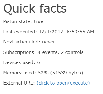

One thing is now my memory utilized looks high. LIke 52%. Should I be worried?
Each piston gets 100,000 bytes of memory. This includes the code you compile as well as things like undo actions and logs. Not to worry if it gets higher. It will delete old logs when it needs to make room.
