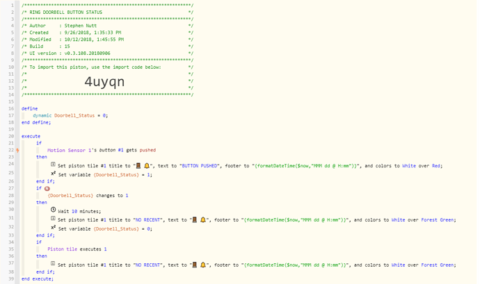

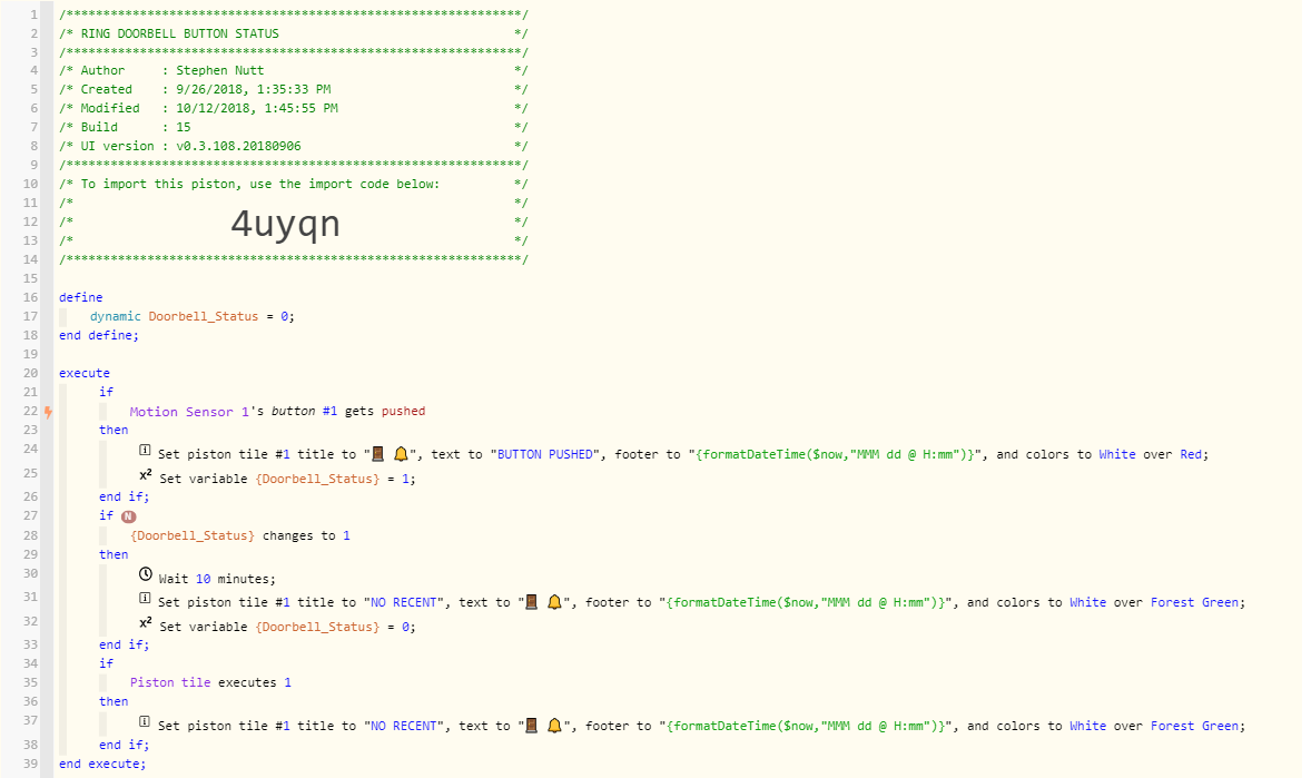

Action not occurring after a designated 10 minute wait
Changing piston tile after a 10 minute wait after Ring Doorbell button is pushed is not occurring.
Piston Tile should turn back to green after 10 minutes
Piston is remaining red

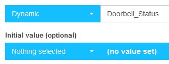

Line 17 in your “define” section needs to be blank
temp
otherwise it forces in 0 each time the piston fires
I would also place the 10 minute wait directly after line 25,
and change line 28 to a condition (IF DBstatus is 1)
Otherwise, after the 10 minute wait, the trigger would have expired
Thank you, I will try that. I couldn’t figure out your line references until I looked at the Green Snapshot and saw that it adds a section at the top for the import code.
Yes, the numbers I gave are based on the screenshot you shared with us
