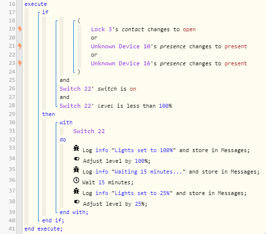

I have a “Wait 15 minutes” action and then a couple more actions. The following actions aren’t executing.
Wait 15 minutes and then execute the two remaining actions (write to log file and set light level)
The final two actions aren’t executing.
10/14/2020, 9:50:33 PM +550ms
+4ms ╔Received event [Babysitter Presence Sensor].presence = present with a delay of 73ms, canQueue: true, calledMyself: false
+404ms ║RunTime initialize > 402 LockT > 2ms > rtDT > 381ms > pistonT > 380ms (first state access 19 7 395)
+409ms ║Runtime (8743 bytes) successfully initialized in 381ms (v0.3.110.20200916_HE)
+412ms ║╔Execution stage started
+438ms ║║Condition #3 evaluated false (10ms)
+447ms ║║Condition #4 evaluated false (8ms)
+454ms ║║Condition #5 evaluated false (6ms)
+461ms ║║Comparison (enum) present changes_to (string) present = true (1ms)
+464ms ║║Cancelling condition #15’s schedules…
+466ms ║║Condition #15 evaluated true (10ms)
+469ms ║║Cancelling condition #2’s schedules…
+471ms ║║Condition group #2 evaluated true (state changed) (44ms)
+480ms ║║Comparison (enum) on is (string) on = true (4ms)
+483ms ║║Condition #6 evaluated true (10ms)
+491ms ║║Comparison (integer) 25 is_less_than (integer) 100 = true (2ms)
+493ms ║║Condition #7 evaluated true (9ms)
+495ms ║║Cancelling condition #1’s schedules…
+497ms ║║Condition group #1 evaluated true (state changed) (72ms)
+500ms ║║Cancelling statement #8’s schedules…
+513ms ║║Lights set to 100%
+516ms ║║Executed virtual command [Garage Outdoor Lights].log (4ms)
+693ms ║║Executed physical command [Garage Outdoor Lights].setLevel([100], ) (167ms)
+695ms ║║Executed virtual command [Garage Outdoor Lights].adjustLevel (172ms)
+705ms ║║Waiting 15 minutes…
+707ms ║║Executed virtual command [Garage Outdoor Lights].log (2ms)
+715ms ║║Executed virtual command [Garage Outdoor Lights].wait (1ms)
+722ms ║║Requesting a wake up for Wed, Oct 14 2020 @ 10:05:34 PM EDT (in 900s)
+738ms ║╚Execution stage complete. (326ms)
+793ms ║Setting up scheduled job for Wed, Oct 14 2020 @ 10:05:34 PM EDT (in 900s)
+795ms ╚Event processed successfully (793ms)

I had missed that in the event selection and clicked “Adjust level” and that didn’t work either. So I was fighting multiple issues. Thanks again!
