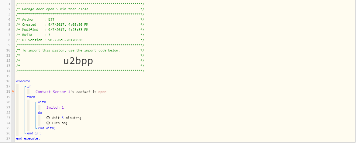

I have a contact sensor on my garage door, and also a z-wave relay switch to close the door.
This simple rule will close the door after X minutes (5 in this example).
How can I add a virtual switch (or any other method) to cancel the automatic closing of the door after 5 minutes?
In Rule Machine I was able to use a “Disable door relay” virtual switch, activated from my phone, to stop the automatic closing if I want it left open.
Any assistance would be greatly appreciated.
IF
Contact Sensor 1’s contact IS open
AND
Virtual Switch 1’s Switch IS off
THEN
with switch 1
wait 5 minutes
turn on
