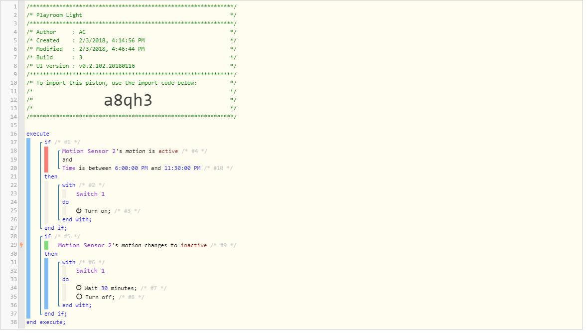

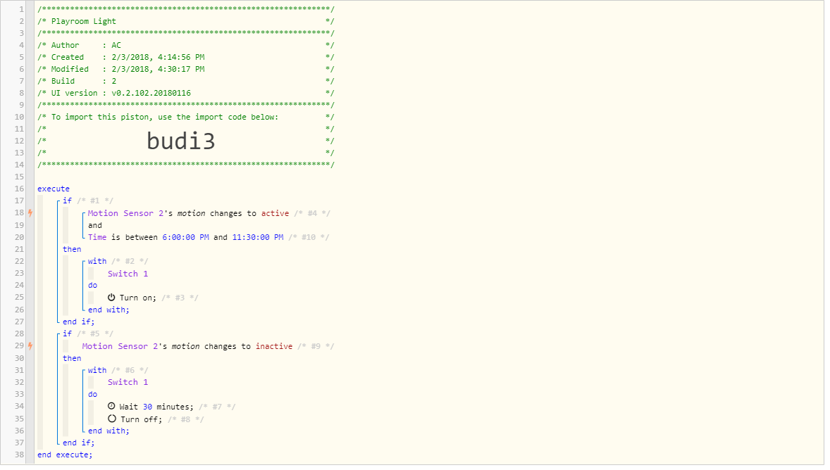

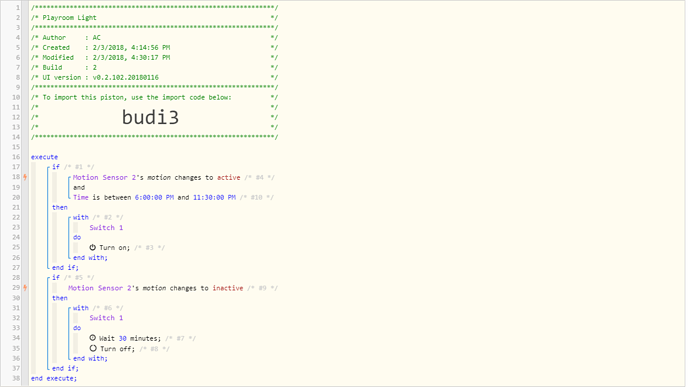

Adding Time Element To A Piston
Light still comes on outside of time variable
Light not to turn on until 6 PM
Light comes on regardless of time as long as potion is detected

Can you post a green snapshot instead of a screenshot… also, turn logging to full and trigger some motion and post that as well.
Done. I hope I added the log info in the correct manner.
Is there a time window when you want the lights to turn on. Say 6pm to 11pm or 4am maybe.
If so I would suggest you change the time to a window.
So instead of Time is after 6pm.
Use Time is between 6pm and 4am.
That’s a good suggestion and I’ve added that, but the light still comes on outside those hours as the piston is written.
Can you type $time24 into an expression window and confirm your hub is setup for the correct time.
Green snapshot (green camera button on the piston overview page) would help.
It may be a clash between conditions and triggers.
Try changing you piston to:
IF
motion IS active
AND
time IS between x and y
THEN
turn on
ELSE
wait 30 seconds
turn off
Expression shows correct current time.
I tried your change and the lamp still turns on when I walk in the room and it’s not 6PM local yet.
