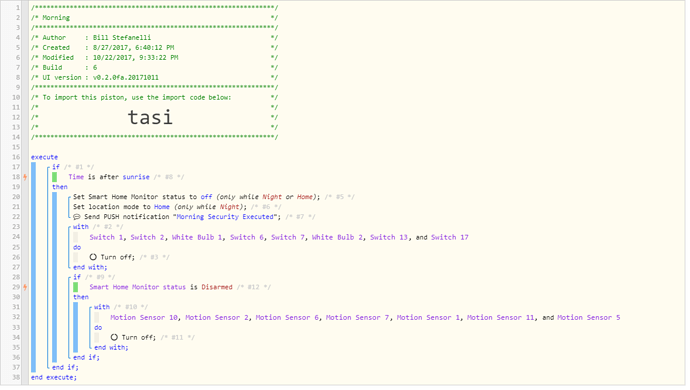

**1) Give a description of the problem
Piston that executes after Sunrise suddenly executing when SHM Status changes to Armed
Piston only executes when time changes to after Sunrise
The Piston is executing whenever I change SHM Status to Armed manually (testing other stuff). This Piston has been working for many months without issue. I can’t figure out what’s happening from the Log, I do see a timer setup for the coming midnight, this makes sense. Can’t imagine why its popping now, and why setting the SHM Status would have any affect on this.

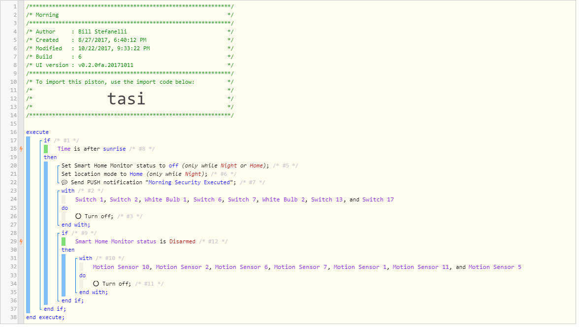

╔Received event [Home].alarmSystemStatus = off with a delay of 70ms
+401ms ║RunTime Analysis CS > 22ms > PS > 323ms > PE > 56ms > CE
+413ms ║Piston waited at a semaphore for 264ms
+415ms ║Runtime (40330 bytes) successfully initialized in 323ms (v0.2.0fa.20171011) (413ms)
+416ms ║╔Execution stage started
+452ms ║║Comparison (time) 78422795 is_after (time) 1508671080000 = true (5ms)
+453ms ║║Time restriction check passed
+454ms ║║Condition #8 evaluated true (32ms)
+455ms ║║Cancelling statement #8’s schedules…
+460ms ║║Requesting time schedule wake up at Mon, Oct 23 2017 @ 12:00:00 AM EDT
+463ms ║║Condition group #1 evaluated true (state did not change) (41ms)
+465ms ║║Cancelling statement #4’s schedules…
+491ms ║║Executed virtual command setAlarmSystemStatus (23ms)
+492ms ║║Skipping task 6 because of mode restrictions
+504ms ║║Executed virtual command sendPushNotification (8ms)
+507ms ║║Cancelling statement #2’s schedules…
+518ms ║║Skipped execution of physical command [Back Porch Light].off([]) because it would make no change to the device. (7ms)
+518ms ║║Executed [Back Porch Light].off (7ms)
+524ms ║║Skipped execution of physical command [Driveway Light].off([]) because it would make no change to the device. (3ms)
+525ms ║║Executed [Driveway Light].off (5ms)
+531ms ║║Skipped execution of physical command [Foyer Light].off([]) because it would make no change to the device. (3ms)
+532ms ║║Executed [Foyer Light].off (4ms)
+536ms ║║Skipped execution of physical command [Front Porch Light].off([]) because it would make no change to the device. (2ms)
+537ms ║║Executed [Front Porch Light].off (4ms)
+544ms ║║Skipped execution of physical command [Garage Lights].off([]) because it would make no change to the device. (5ms)
+545ms ║║Executed [Garage Lights].off (7ms)
+550ms ║║Skipped execution of physical command [Living Room Table Light].off([]) because it would make no change to the device. (3ms)
+551ms ║║Executed [Living Room Table Light].off (5ms)
+559ms ║║Skipped execution of physical command [Outdoor Landscape].off([]) because it would make no change to the device. (6ms)
+560ms ║║Executed [Outdoor Landscape].off (7ms)
+565ms ║║Skipped execution of physical command [Wine Rack Light].off([]) because it would make no change to the device. (3ms)
+566ms ║║Executed [Wine Rack Light].off (5ms)
+575ms ║║Comparison (string) off is (string) off = true (2ms)
+577ms ║║Condition #12 evaluated true (7ms)
+578ms ║║Condition group #9 evaluated true (state did not change) (9ms)
+580ms ║║Cancelling statement #10’s schedules…
+588ms ║║Skipped execution of physical command [Driveway Camera].off([]) because it would make no change to the device. (3ms)
+589ms ║║Executed [Driveway Camera].off (4ms)
+595ms ║║Skipped execution of physical command [Front Porch Camera].off([]) because it would make no change to the device. (2ms)
+595ms ║║Executed [Front Porch Camera].off (4ms)
+601ms ║║Skipped execution of physical command [Left Yard Camera 1].off([]) because it would make no change to the device. (3ms)
+602ms ║║Executed [Left Yard Camera 1].off (4ms)
+608ms ║║Skipped execution of physical command [Left Yard Camera 2].off([]) because it would make no change to the device. (3ms)
+609ms ║║Executed [Left Yard Camera 2].off (4ms)
+614ms ║║Skipped execution of physical command [Patio Door Camera].off([]) because it would make no change to the device. (3ms)
+615ms ║║Executed [Patio Door Camera].off (4ms)
+621ms ║║Skipped execution of physical command [Patio Left Camera].off([]) because it would make no change to the device. (3ms)
+622ms ║║Executed [Patio Left Camera].off (5ms)
+632ms ║║Skipped execution of physical command [Patio Right Camera].off([]) because it would make no change to the device. (7ms)
+633ms ║║Executed [Patio Right Camera].off (8ms)
+636ms ║╚Execution stage complete. (220ms)
+638ms ║Setting up scheduled job for Mon, Oct 23 2017 @ 12:00:00 AM EDT (in 7976.99s)
+671ms ╚Event processed successfully (671ms)
