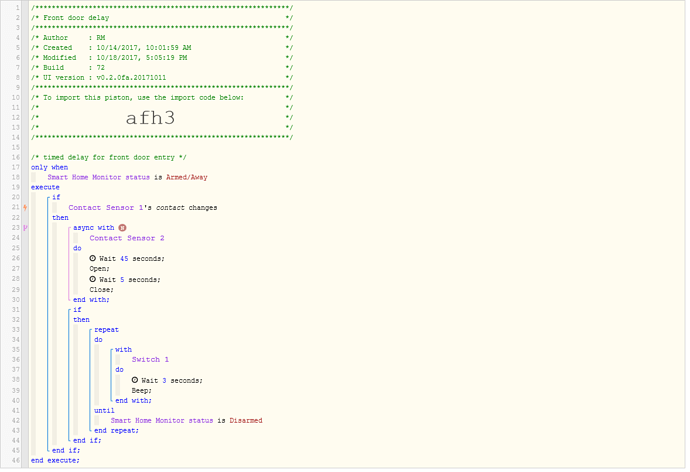

I’m looking for a solution to the alarm entry delay that is missing from SHM. I have a simulated switch (Contact sensor 2) that is the trigger for SHM. Also looking for a chime/alert from inside buzzer until alarm is disabled.
It seems to work OK but I’m looking to make it more efficient or expose any flaws.

I attempted to port my existing (legacy original CoRE) Pistons I had been running for my alarm entry delay setup, but unfortunately I haven’t been successful. Admittedly, my original Pistons were pretty gnarly, but they worked well.
In any event, I am testing your webCoRE piston logic on my own setup, and I can post back my findings. I just need to wait for the next opportunity in which the family isn’t present, false Siren triggers tend to erode the WAF :slight_smile:
