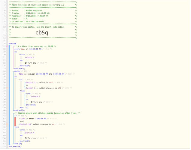

Alarm not disarming
Alarm not disarming when kitchen lights turned on
After 7 am, when the kitchen lights are turned on, the alarm system should be disarmed.
nothing
3/30/2018, 9:06:36 AM +102ms
+1ms ╔Received event [Arm Stay].switch = off with a delay of 52ms
+78ms ║RunTime Analysis CS > 11ms > PS > 30ms > PE > 36ms > CE
+80ms ║Runtime (39930 bytes) successfully initialized in 30ms (v0.3.104.20180323) (79ms)
+95ms ║║Comparison (time) 32796190 is_between (time) 79200000 … (time) 25200000 = false (5ms)
+97ms ║║Condition #20 evaluated false (8ms)
+97ms ║║Condition group #19 evaluated false (state did not change) (10ms)
+105ms ║║Comparison (time) 32796202 is_after (time) 25200000 = true (4ms)
+106ms ║║Time restriction check passed
+107ms ║║Condition #14 evaluated true (7ms)
+114ms ║║Condition #15 evaluated false (6ms)
+115ms ║║Condition group #11 evaluated false (state did not change) (16ms)
+117ms ║╚Execution stage complete. (36ms)
+119ms ║Setting up scheduled job for Fri, Mar 30 2018 @ 10:00:00 PM CDT (in 46403.78s)
+128ms ╚Event processed successfully (127ms)
3/30/2018, 9:06:24 AM +335ms
+2ms ╔Received event [Arm Stay].switch = on with a delay of 316ms
+109ms ║RunTime Analysis CS > 18ms > PS > 53ms > PE > 38ms > CE
+111ms ║Runtime (39931 bytes) successfully initialized in 53ms (v0.3.104.20180323) (108ms)
+126ms ║║Comparison (time) 32784454 is_between (time) 79200000 … (time) 25200000 = false (5ms)
+128ms ║║Condition #20 evaluated false (9ms)
+129ms ║║Condition group #19 evaluated false (state did not change) (10ms)
+137ms ║║Comparison (time) 32784466 is_after (time) 25200000 = true (3ms)
+138ms ║║Time restriction check passed
+139ms ║║Condition #14 evaluated true (8ms)
+146ms ║║Condition #15 evaluated false (6ms)
+146ms ║║Condition group #11 evaluated false (state did not change) (15ms)
+149ms ║╚Execution stage complete. (37ms)
+150ms ║Setting up scheduled job for Fri, Mar 30 2018 @ 10:00:00 PM CDT (in 46415.515s)
+160ms ╚Event processed successfully (160ms)
3/30/2018, 7:35:26 AM +499ms
+1ms ╔Received event [Arm Stay].switch = off with a delay of 398ms
+304ms ║RunTime Analysis CS > 223ms > PS > 47ms > PE > 33ms > CE
+306ms ║Runtime (39933 bytes) successfully initialized in 47ms (v0.3.104.20180323) (304ms)
+307ms ║╔Execution stage started
+323ms ║║Comparison (time) 27326814 is_between (time) 79200000 … (time) 25200000 = false (7ms)
+324ms ║║Condition #20 evaluated false (10ms)
+325ms ║║Condition group #19 evaluated false (state did not change) (11ms)
+334ms ║║Comparison (time) 27326827 is_after (time) 25200000 = true (5ms)
+335ms ║║Time restriction check passed
+336ms ║║Condition #14 evaluated true (8ms)
+343ms ║║Condition #15 evaluated false (6ms)
+344ms ║║Condition group #11 evaluated false (state did not change) (17ms)
+347ms ║╚Execution stage complete. (40ms)
+348ms ║Setting up scheduled job for Fri, Mar 30 2018 @ 10:00:00 PM CDT (in 51873.153s)
+360ms ╚Event processed successfully (360ms)
3/30/2018, 7:27:10 AM +825ms
+2ms ╔Received event [Kitchen Lights].switch = on with a delay of 667ms
+109ms ║RunTime Analysis CS > 23ms > PS > 53ms > PE > 34ms > CE
+111ms ║Runtime (39932 bytes) successfully initialized in 53ms (v0.3.104.20180323) (109ms)
+126ms ║║Comparison (time) 26830944 is_between (time) 79200000 … (time) 25200000 = false (5ms)
+136ms ║║Comparison (time) 26830956 is_after (time) 25200000 = true (3ms)
+137ms ║║Time restriction check passed
+139ms ║║Condition #14 evaluated true (7ms)
+142ms ║║Comparison (enum) on changes_to (string) on = false (1ms)
+143ms ║║Cancelling condition #15’s schedules…
+144ms ║║Condition #15 evaluated false (5ms)
+145ms ║║Cancelling condition #11’s schedules…
+146ms ║║Condition group #11 evaluated false (state changed) (15ms)
+148ms ║╚Execution stage complete. (36ms)
+150ms ║Setting up scheduled job for Fri, Mar 30 2018 @ 10:00:00 PM CDT (in 52369.026s)
3/29/2018, 10:41:57 PM +625ms
+1ms ╔Received event [Pepper Bush].time/recovery = 1522381317624 with a delay of 0ms
+84ms ║RunTime Analysis CS > 19ms > PS > 36ms > PE > 30ms > CE
+86ms ║Runtime (39944 bytes) successfully initialized in 36ms (v0.3.104.20180323) (84ms)
+87ms ║╔Execution stage started
+88ms ║╚Execution stage complete. (1ms)
+90ms ║Setting up scheduled job for Fri, Mar 30 2018 @ 10:00:00 PM CDT (in 83882.286s)
+100ms ╚Event processed successfully (100ms)
3/29/2018, 10:20:49 PM +992ms
+2ms ╔Received event [Pepper Bush].time/recovery = 1522380049991 with a delay of 1ms
+117ms ║RunTime Analysis CS > 20ms > PS > 56ms > PE > 40ms > CE
+119ms ║Runtime (39945 bytes) successfully initialized in 56ms (v0.3.104.20180323) (116ms)
+122ms ║╚Execution stage complete. (1ms)
+123ms ║Setting up scheduled job for Fri, Mar 30 2018 @ 10:00:00 PM CDT (in 85149.885s)
+134ms ╚Event processed successfully (133ms)
3/29/2018, 10:00:25 PM +29ms
+1ms ╔Received event [Pepper Bush].time/recovery = 1522378825029 with a delay of 0ms
+127ms ║RunTime Analysis CS > 22ms > PS > 57ms > PE > 48ms > CE
+129ms ║Runtime (39945 bytes) successfully initialized in 57ms (v0.3.104.20180323) (128ms)
+131ms ║╚Execution stage complete. (1ms)
+133ms ║Setting up scheduled job for Fri, Mar 30 2018 @ 10:00:00 PM CDT (in 86374.839s)
+143ms ╚Event processed successfully (142ms)
3/29/2018, 9:59:59 PM +659ms
+0ms ╔Received event [Pepper Bush].time = 1522378800000 with a delay of -342ms
+143ms ║RunTime Analysis CS > 31ms > PS > 66ms > PE > 47ms > CE
+146ms ║Runtime (39939 bytes) successfully initialized in 66ms (v0.3.104.20180323) (145ms)
+166ms ║║Cancelling statement #17’s schedules…
+3712ms ║║Executed physical command [Arm Stay].on() (3542ms)
+3714ms ║║Executed [Arm Stay].on (3544ms)
+3718ms ║╚Execution stage complete. (3571ms)
+3721ms ║Setting up scheduled job for Fri, Mar 30 2018 @ 10:00:00 PM CDT (in 86396.621s)
+3728ms ╚Event processed successfully (3729ms)
3/29/2018, 7:06:18 PM +76ms
+1ms ╔Received event [Kitchen Lights].switch = on with a delay of 760ms
+71ms ║RunTime Analysis CS > 16ms > PS > 31ms > PE > 25ms > CE
+73ms ║Runtime (39937 bytes) successfully initialized in 31ms (v0.3.104.20180323) (72ms)
+89ms ║║Comparison (time) 68778157 is_between (time) 79200000 … (time) 25200000 = false (5ms)
+90ms ║║Condition #20 evaluated false (9ms)
+91ms ║║Condition group #19 evaluated false (state did not change) (10ms)
+99ms ║║Comparison (time) 68778169 is_after (time) 25200000 = true (3ms)
+99ms ║║Time restriction check passed
+101ms ║║Condition #14 evaluated true (8ms)
+104ms ║║Comparison (enum) on changes_to (string) on = true (0ms)
+106ms ║║Cancelling condition #15’s schedules…
+106ms ║║Condition #15 evaluated true (5ms)
+107ms ║║Cancelling condition #11’s schedules…
+108ms ║║Condition group #11 evaluated true (state changed) (15ms)
+110ms ║║Cancelling statement #12’s schedules…
+115ms ║║Skipped execution of physical command [Disarm].on([]) because it would make no change to the device. (3ms)
+116ms ║║Executed [Disarm].on (4ms)
+119ms ║╚Execution stage complete. (45ms)
+120ms ║Setting up scheduled job for Thu, Mar 29 2018 @ 10:00:00 PM CDT (in 10421.804s)
+138ms ╚Event processed successfully (137ms)
3/29/2018, 7:06:14 PM +444ms
+2ms ╔Received event [Kitchen Lights].switch = off with a delay of 705ms
+103ms ║RunTime Analysis CS > 24ms > PS > 53ms > PE > 27ms > CE
+105ms ║Runtime (39933 bytes) successfully initialized in 53ms (v0.3.104.20180323) (103ms)
+121ms ║║Comparison (time) 68774557 is_between (time) 79200000 … (time) 25200000 = false (6ms)
+122ms ║║Condition #20 evaluated false (9ms)
+123ms ║║Condition group #19 evaluated false (state did not change) (10ms)
+131ms ║║Comparison (time) 68774570 is_after (time) 25200000 = true (4ms)
+132ms ║║Time restriction check passed
+133ms ║║Condition #14 evaluated true (8ms)
+137ms ║║Comparison (enum) off changes_to (string) on = false (0ms)
+138ms ║║Cancelling condition #15’s schedules…
+139ms ║║Condition #15 evaluated false (5ms)
+140ms ║║Cancelling condition #11’s schedules…
+140ms ║║Condition group #11 evaluated false (state changed) (15ms)
+143ms ║╚Execution stage complete. (37ms)
+145ms ║Setting up scheduled job for Thu, Mar 29 2018 @ 10:00:00 PM CDT (in 10425.412s)
+153ms ╚Event processed successfully (153ms)
3/29/2018, 9:55:27 AM +892ms
+2ms ╔Received event [Kitchen Lights].switch = on with a delay of 1107ms
+90ms ║RunTime Analysis CS > 21ms > PS > 42ms > PE > 26ms > CE
+92ms ║Runtime (39938 bytes) successfully initialized in 42ms (v0.3.104.20180323) (89ms)
+106ms ║║Comparison (time) 35727991 is_between (time) 79200000 … (time) 25200000 = false (5ms)
+108ms ║║Condition #20 evaluated false (9ms)
+109ms ║║Condition group #19 evaluated false (state did not change) (9ms)
+116ms ║║Comparison (time) 35728003 is_after (time) 25200000 = true (4ms)
+117ms ║║Time restriction check passed
+118ms ║║Condition #14 evaluated true (7ms)
+121ms ║║Comparison (enum) on changes_to (string) on = true (0ms)
+123ms ║║Cancelling condition #15’s schedules…
+123ms ║║Condition #15 evaluated true (4ms)
+124ms ║║Cancelling condition #11’s schedules…
+125ms ║║Condition group #11 evaluated true (state changed) (14ms)
+127ms ║║Cancelling statement #12’s schedules…
+132ms ║║Skipped execution of physical command [Disarm].on([]) because it would make no change to the device. (2ms)
+133ms ║║Executed [Disarm].on (4ms)
+136ms ║╚Execution stage complete. (44ms)
+137ms ║Setting up scheduled job for Thu, Mar 29 2018 @ 10:00:00 PM CDT (in 43471.971s)
+147ms ╚Event processed successfully (147ms)
3/29/2018, 8:25:27 AM +194ms
+1ms ╔Received event [Kitchen Lights].switch = off with a delay of 1019ms
+85ms ║RunTime Analysis CS > 15ms > PS > 42ms > PE > 28ms > CE
+87ms ║Runtime (39935 bytes) successfully initialized in 42ms (v0.3.104.20180323) (85ms)
+88ms ║╔Execution stage started
+101ms ║║Comparison (time) 30327289 is_between (time) 79200000 … (time) 25200000 = false (5ms)
+103ms ║║Condition #20 evaluated false (8ms)
+103ms ║║Condition group #19 evaluated false (state did not change) (9ms)
+111ms ║║Comparison (time) 30327300 is_after (time) 25200000 = true (3ms)
+111ms ║║Time restriction check passed
+113ms ║║Condition #14 evaluated true (6ms)
+116ms ║║Comparison (enum) off changes_to (string) on = false (1ms)
+117ms ║║Condition #15 evaluated false (4ms)
+118ms ║║Condition group #11 evaluated false (state did not change) (13ms)
+120ms ║╚Execution stage complete. (32ms)
+121ms ║Setting up scheduled job for Thu, Mar 29 2018 @ 10:00:00 PM CDT (in 48872.685s)
3/29/2018, 7:36:57 AM +976ms
+1ms ╔Starting piston… (v0.3.104.20180323)
+324ms ║╔Subscribing to devices…
+361ms ║║Subscribing to Arm Stay.switch…
+375ms ║║Subscribing to Kitchen Lights.switch…
+454ms ║║Subscribing to Disarm…
+455ms ║╚Finished subscribing (145ms)
+517ms ║Comparison (time) 27418482 is_between (time) 79200000 … (time) 25200000 = false (8ms)
+534ms ║Comparison (enum) off is (string) off = true (2ms)
+566ms ║Comparison (time) 27418532 is_after (time) 25200000 = true (8ms)
+568ms ║Time restriction check passed
+588ms ║Setting up scheduled job for Thu, Mar 29 2018 @ 10:00:00 PM CDT (in 51781.437s)
+605ms ╚Piston successfully started (603ms)

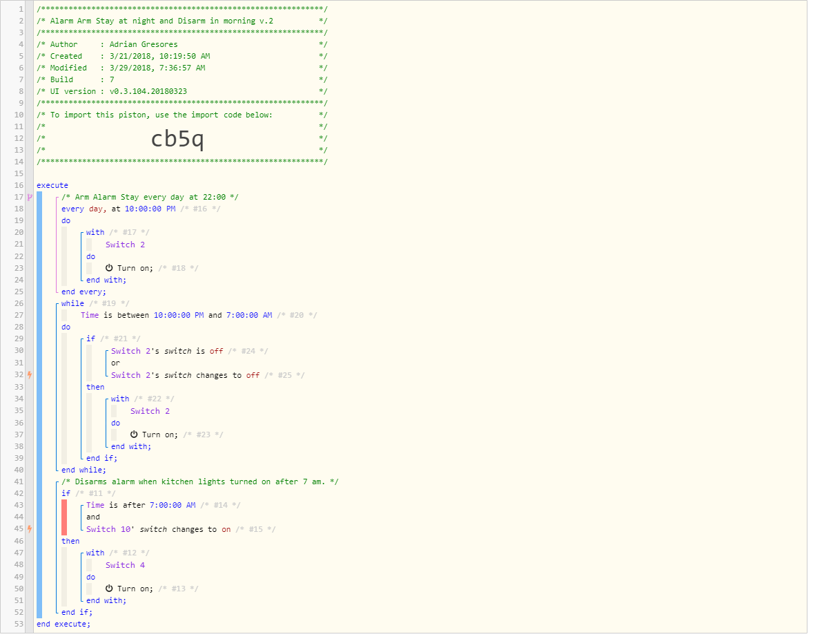

Try rearranging your condition/trigger sequence first. Some odd evaluations when Time is at the beginning of the statement. Swap, line 43 and 45.
Also can try changing the times to restrictions on each IF block.
ONLY WHEN time is between…
IF
Switch changes to on…
etc…
