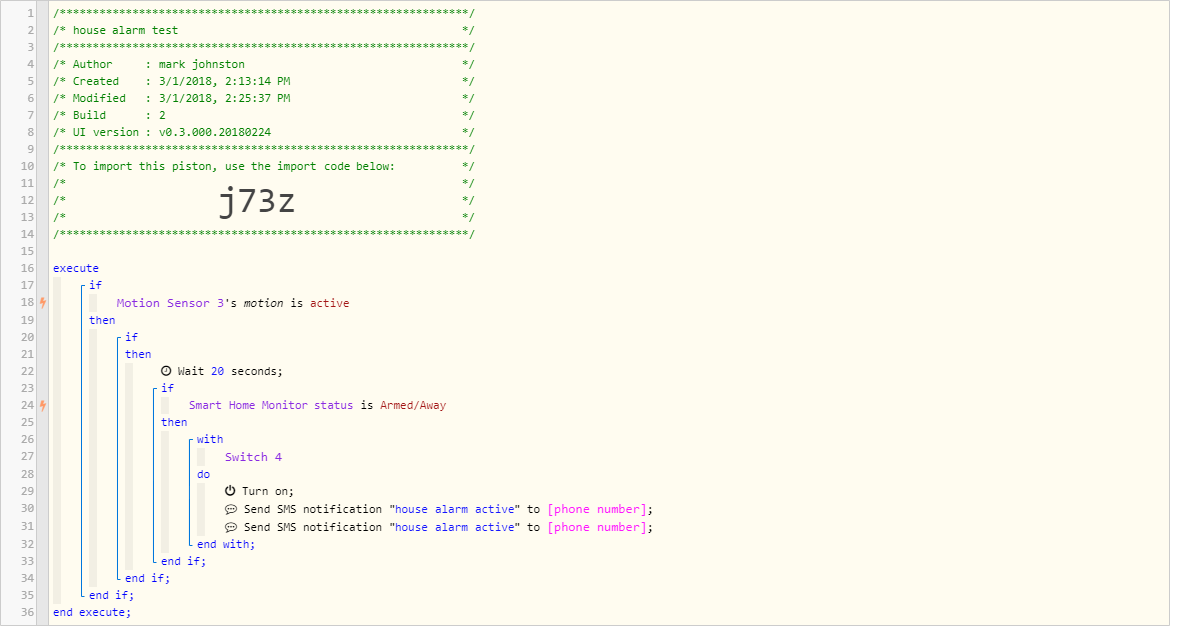

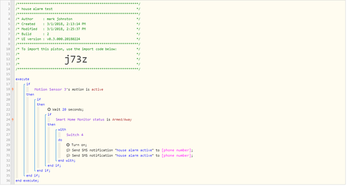

iam trying this piston out which is basically for when i leave and arm the system
so i press arm and obviously when walking out the motion will pick me up. so i added a 25s wait to let me get out.
i was hoping this would work for intruder also. so for example someone brakes in and motion is detected, ( i will program in a warning beep later) after the 25sec wait and motion is still active iam hoping the alarm will then fire and txt the phones??

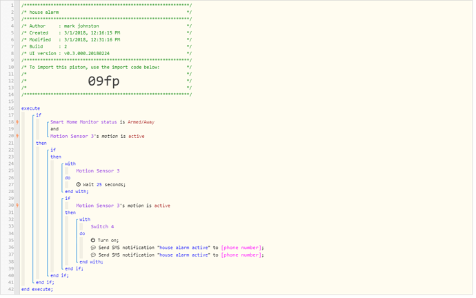

You have a blank IF/THEN in the middle there.
Also, having the current arrangement, it will give you an entry delay, but the delay will cancel each time motion returns to inactive. An intruder would therefore need to trigger motion continuously for 25s to trigger the alarm, which is unlikely if they move between rooms.

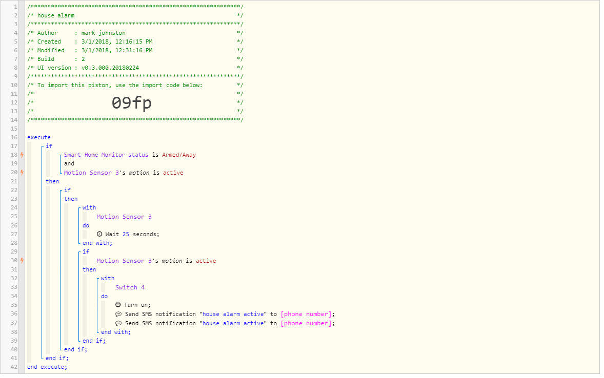

Maybe:
IF
Motion IS active
THEN
… with location (TCP never)
… wait 25 seconds
… IF
… SHM IS Armed
… THEN
… sound alarm
In regards to an exit delay… what method are you currently using to arm the system? Button controller? ActionTiles? ST App?

Click on the ‘with’ containing the wait, click the cog symbol, change TCP to ‘never’.
So you have a tablet on the wall with the arm / disarm buttons… that’s handy for the intruder lol… definitely move over to ActionTiles as you can password protect the tile.

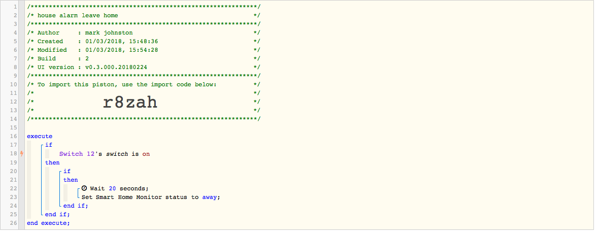

Suggest you use a simulated momentary device to arm the system though… you can then build a seperate piston to delay arming and give you time to get out.
IF
simulated momentary tile IS on
THEN
with location (never cancel)
wait x seconds
set SHM to Armed.

so my piston above should work fine for the home delay??
Will work for arriving, not leaving.
That’s why I suggest delaying the arming function using a simulated switch.
Better yet… get some ST arrival sensors and arm / disarm the system automatically… that’s what HA / webCoRE is really about, not just a glorified remote control.

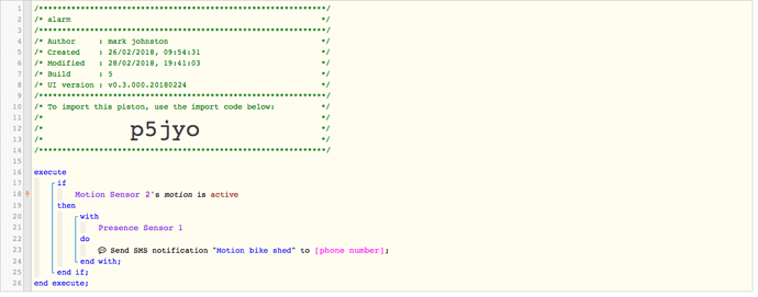

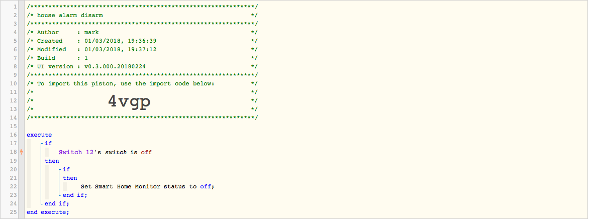

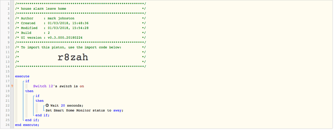

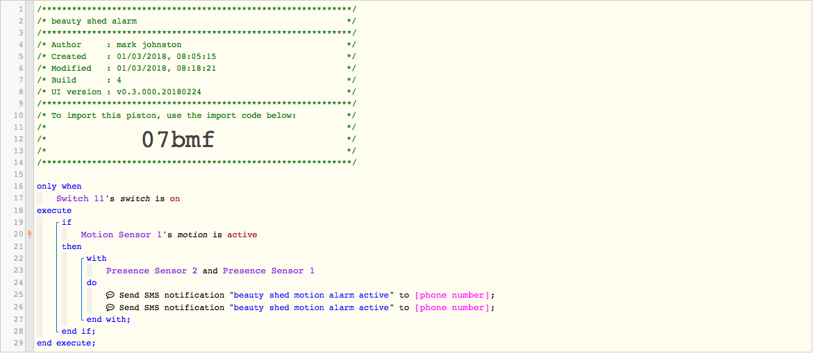

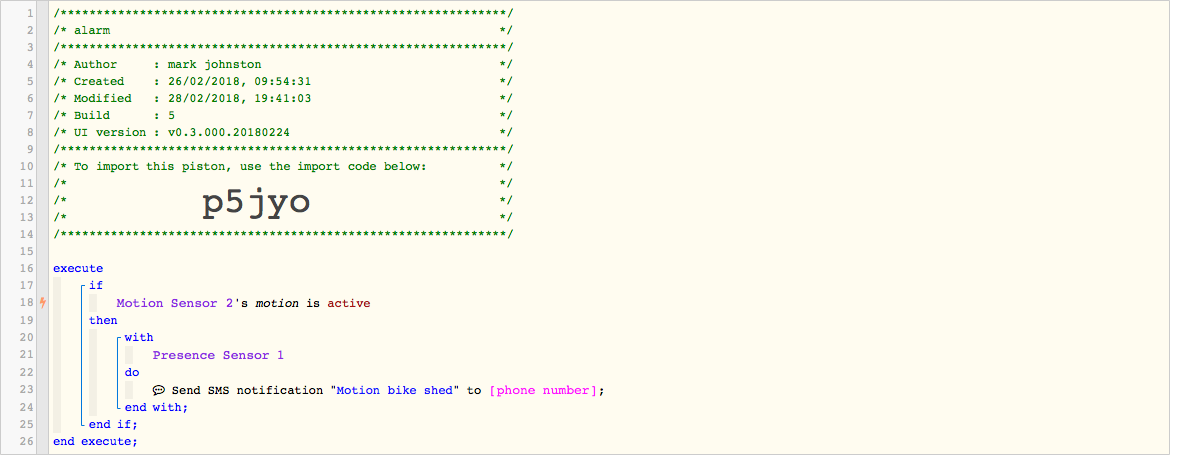

so heres is what I have come up with and have tested them all and the seem to work fine.
I have 2 out buildings and I wanted to bet able to arm them separately so I created 2 devices in the ide and made 2 pistons which are below
next was the house alarm so I created another device in the ide called in house alarm and created the piston you suggested and I also created another for disarming.
