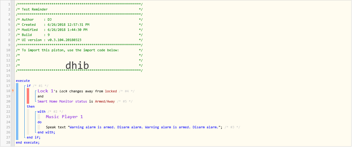

I’m using SMHDelay so that I am able to leave when I set Armed Away. That works great. When I come home I always forget to disable the alarm because there is no beeping or warning.
I’ve created a piston that announces through my sonos speaker that the alarm is armed. The only problem is that the way I wrote it I have to unlock the door first because there is no delay and it make the announcement.
I would like to set my system to Arm Away, have it allow me to leave and then alert me when I come back in that the alarm is armed.
