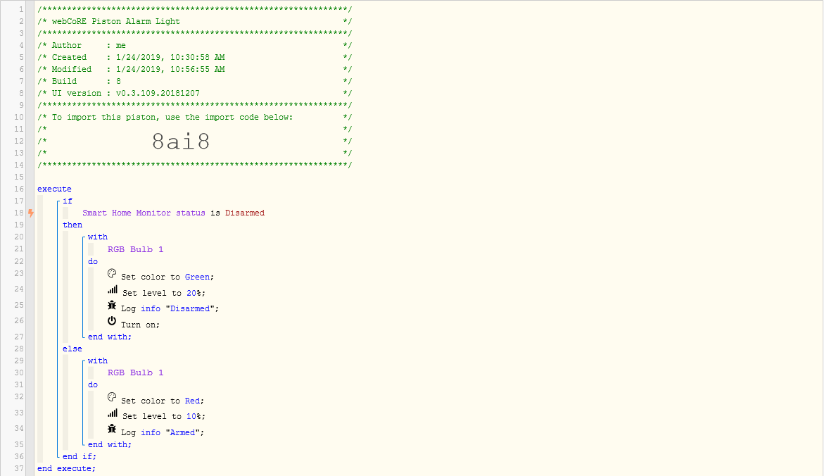

Newbie here. I want the RGBW light to be red when the alarm is armed, and green when disarmed. Red works fine but the light turns off instead of green.
Thanks
Light should be red when alarm is armed and green when it is disarmed.
Red works fine, but the bulb turns off instead of green. Logging shows the green path is being executed. If I change the if statement to “Is Not” then the bulb turns green so I know green works on the bulb.

Hi @mastoo
did you try this:
IF status is (or CHANGES TO) DISARMED
RGB is GREEN
IF Status is (or rather CHANGES TO) ARMED
RGB is RED
using two seperate IFs instead of ELSE
You have no OFF command anywhere in this piston, so there is likely some old programming still in effect elsewhere.
I was thinking “Of course I’m not turning the bulb off somewhere else”.
Then I noticed it is also plugged into a smartthings outlet, and sure enough that outlet was connected to the alarm status. I cleaned that up and everything worked fine. Thanks for steering me towards my oversight!
And thanks both of you for the quick responses.
