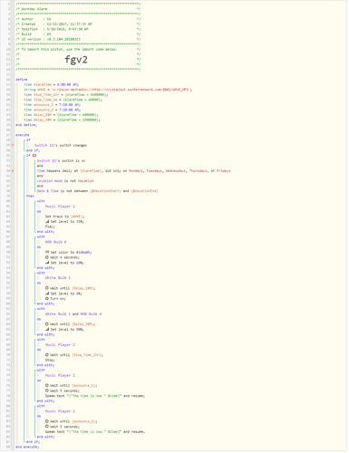

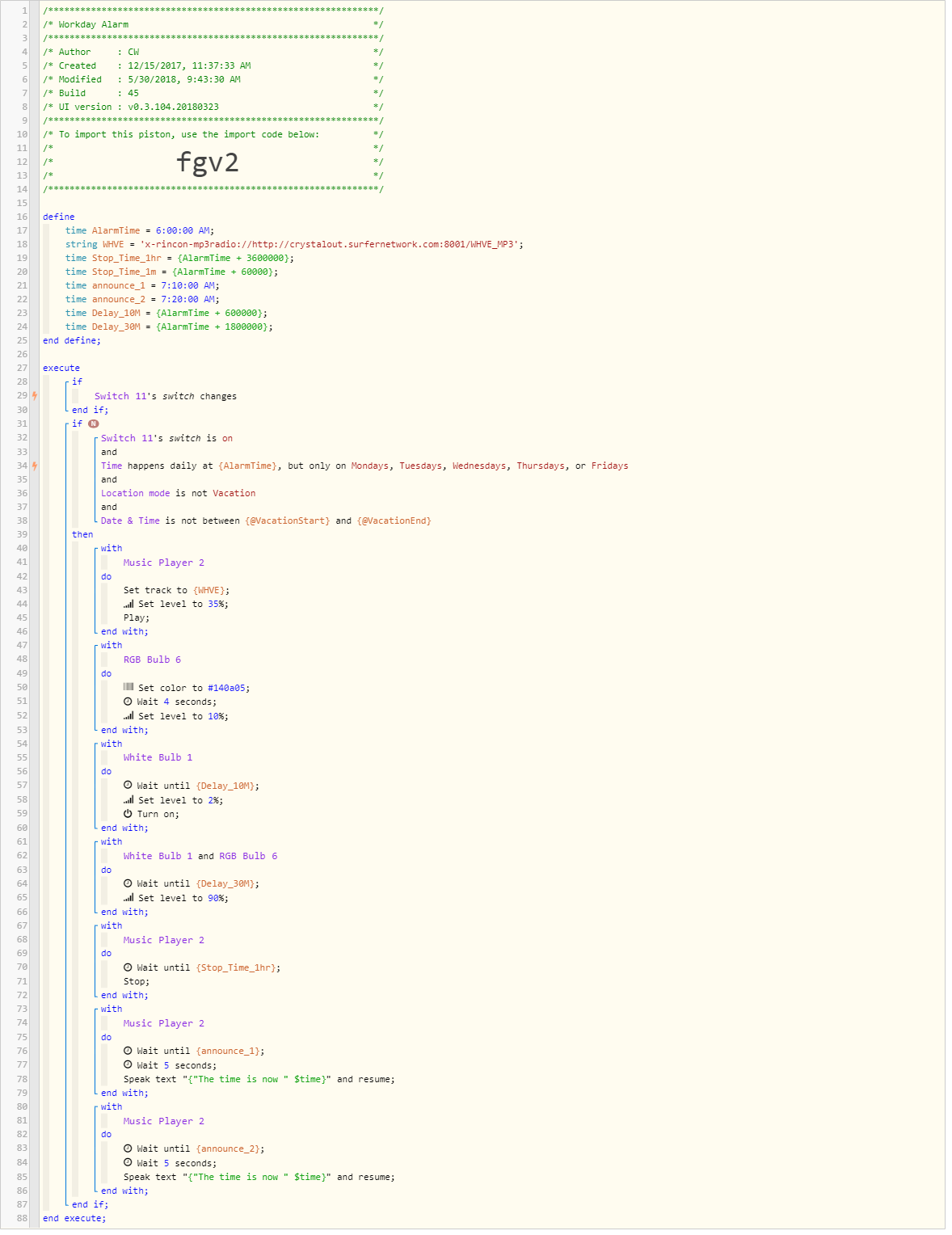

Alarm stops before finishing all tasks
  1. Give a description of the problem
    Need to figure out what went wrong
  2. What is the expected behavior?
    Sonos plays, light comes on, delay, another light comes on, delay, both lights go to 90%, delay, sonos stops, delay, sonos states time X2
  3. What is happening/not happening?
    Today, the Sonos came on, the light came on, and no other actions took place after Delay_10M.
  4. Post a Green Snapshot of the piston
  5. Attach any logs (From ST IDE 1 and by turning logging level to Full)
    Turned to Full today, might have logs tomorrow.
I would also like to insert some kind of a cancel function, so that I can pause it if I forget to turn it off on holidays.

I would create a virtual switch which you can toggle, this would let you choose if the alarm should be on or not.
As for it not running, I can see it gets to the 10 minutes wait and then schedules the piston to run again in ten minutes from the beginning. When it gets back to there all the original conditions at the top of the piston are no longer true and hence it doesn’t run anything else.
New Development, Friday and today it has decided to work as expected again.
I’m not sure what on earth made it confused for a couple of days, but maybe it will act accordingly now.
For every WITH statement that has a wait in it, click on the WITH statement, then the gear cog at the bottom to expand settings. Change your Task Cancellation Policy to “never cancel tasks”.
After any wait (longer than 3 seconds I think, usually) the IF condition is evaluated again. If it evaluates false, all pending tasks are cancelled. By changing your task cancellation policy, your piston will continue to run regardless of how the IF condition re-evaluates.
