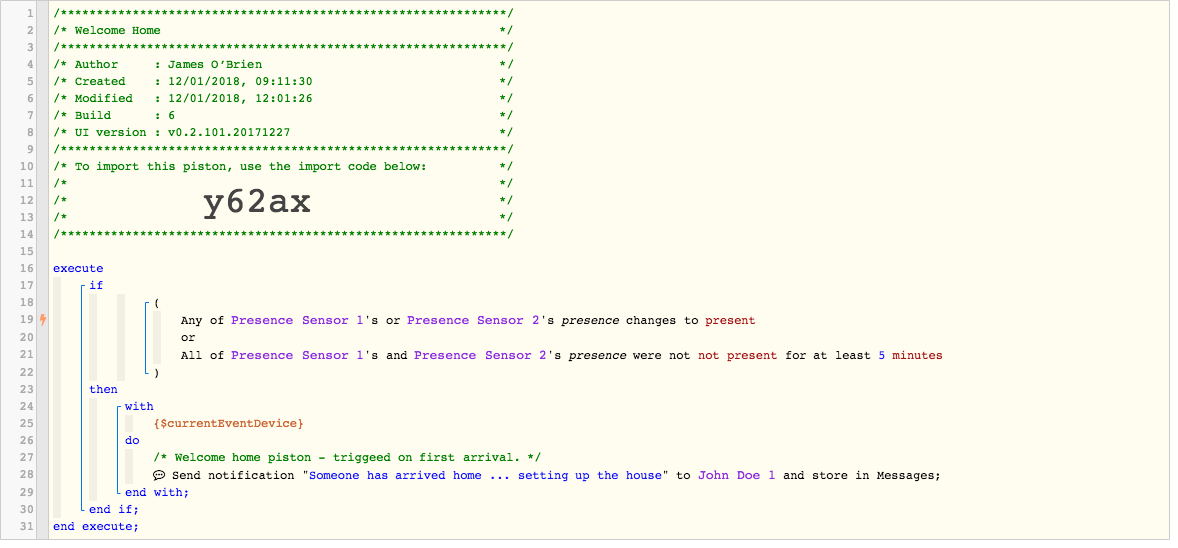

Try something along the lines of this
If any of presence 1 or presence 2 changes to present
And
both of presence 1 and presence 2 were not present for XX minutes
Do your actions
End if
Thanks for the advice.
This is the piston, I’ve not set any action apart from sending a test message
However it its not working as expected.
When I popped out, I drive out and back into the location zone, and I received the test message despite the changes taking place within the 5 minute window.

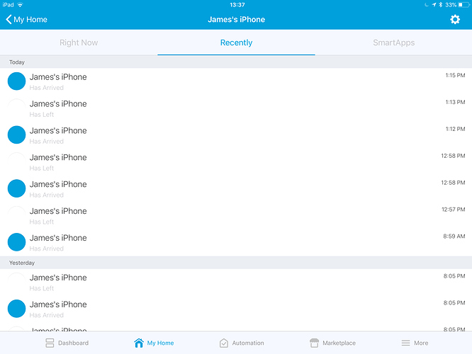

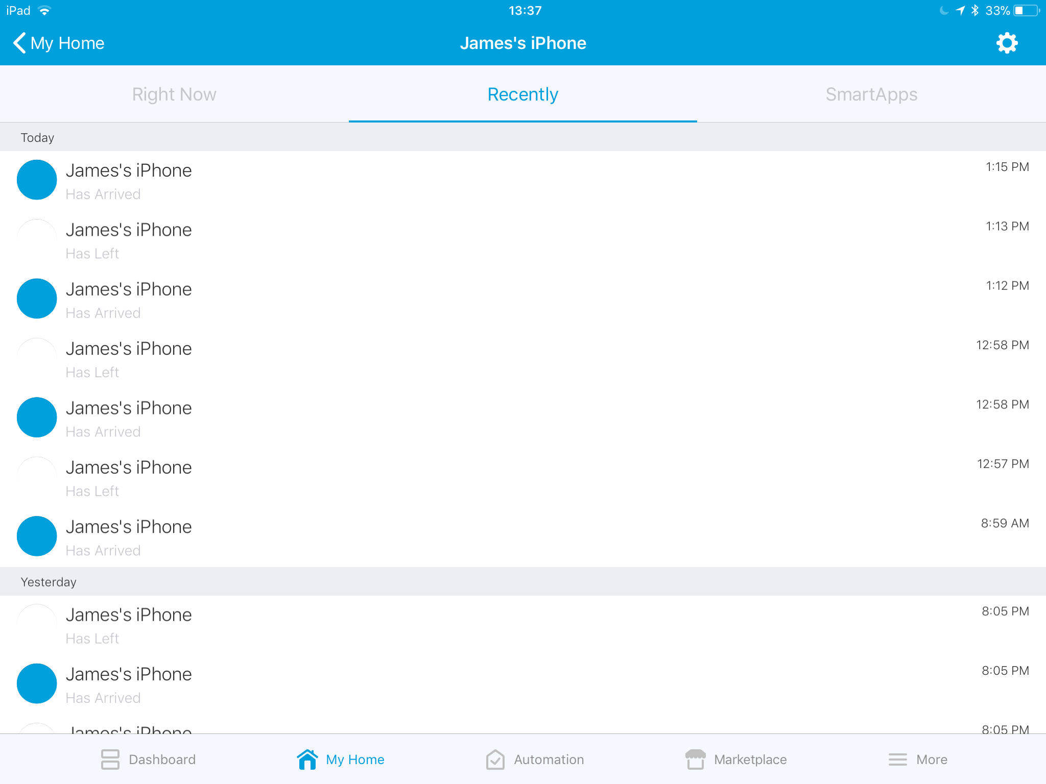

I have posted a copy of the SmartThings presence log as well as the webcore log below.

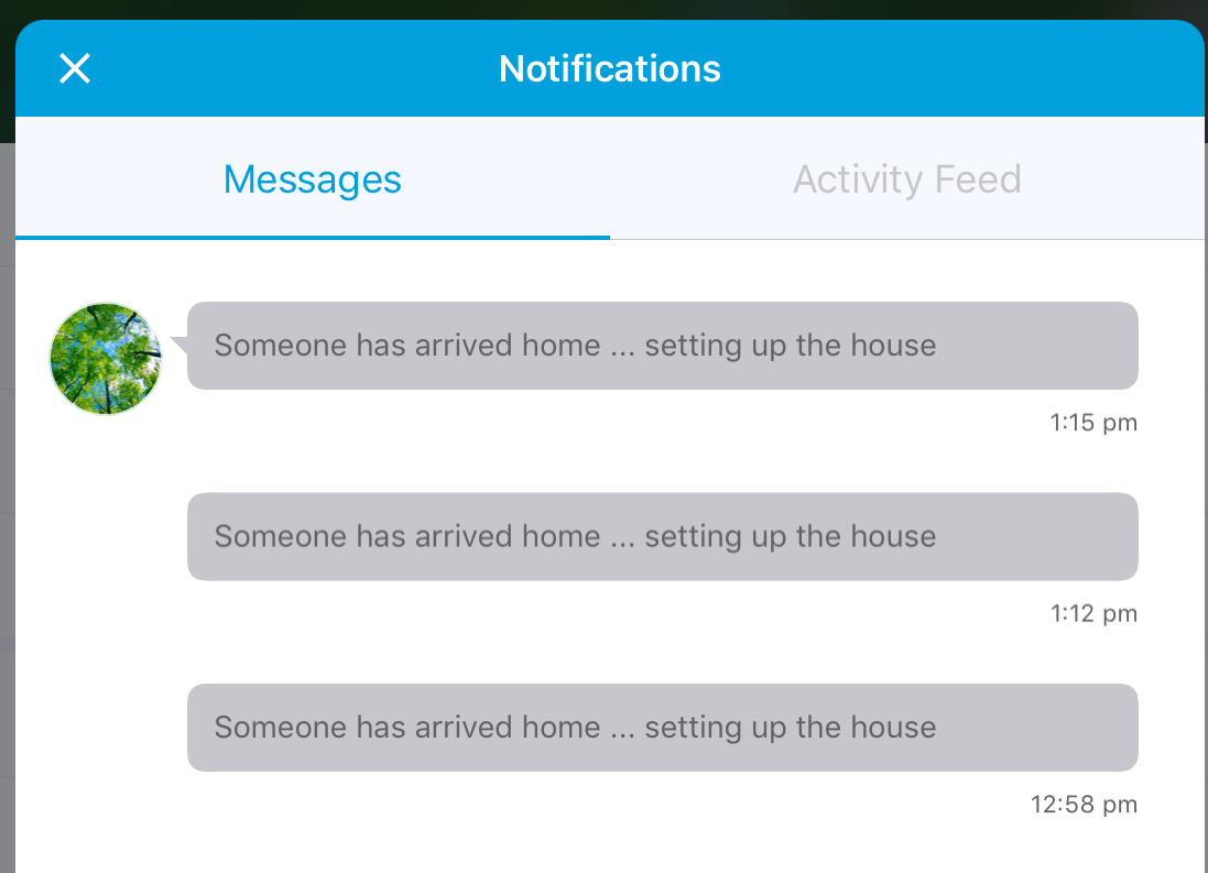

I can’t quite work out why this is happening as it is triggering if I leave and return within the 5 minutes as well as if it outside the 5 minute window.
Below is a screenshot of the messages received:
I think I have just seen my mistake, the IF statement is OR not AND.
I’ll change this first and try again.
Yeah, that was it…
