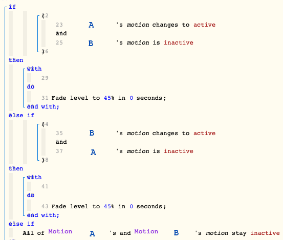

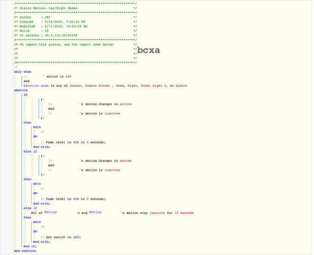

My language might have been misleading, but I do understand the wakeup is scheduled when they turn inactive. I am posting a snapshot of my piston now. As you mention triggers, It is true I have the off statement as an “else if” below the two statement that turn on the lights. Perhaps this is a reason?

I am not trying to be nosy, but can you insert fake names next to the sensors so I can see how many devices you are referring to, and their relationship to each other?
I am assuming something like this:
pic
For what it’s worth, the STAYS INACTIVE block should be a separate block.
(not sure about the other ELSE IF until you answer my above question)
It is normal (and easy) to abort when a condition changes.
(if you avoid ELSE IF and make independent blocks instead)
Update- Moving it to its own block works great it seems!
You are correct in your assumption on the devices and their relationships.
The “else if” is to stop a re-trigger, not that it really matters I suppose.However, I was trying to be efficient by not making two calls to the Piston when I really only need one depending on the direction I am going on the stairs
I will start by making the statement for the motion inactive its own block.
Sweet!
I do not see anything in your code that encourages a double trigger.
… and splitting into separate blocks will not create double triggers either.
(although keep in mind that either device can still do that)
Basically, an “ELSE IF” can not stop a second trigger. If there is a lightning bolt in the left margin, then whenever that device’s attribute changes, the piston will run top to bottom.
