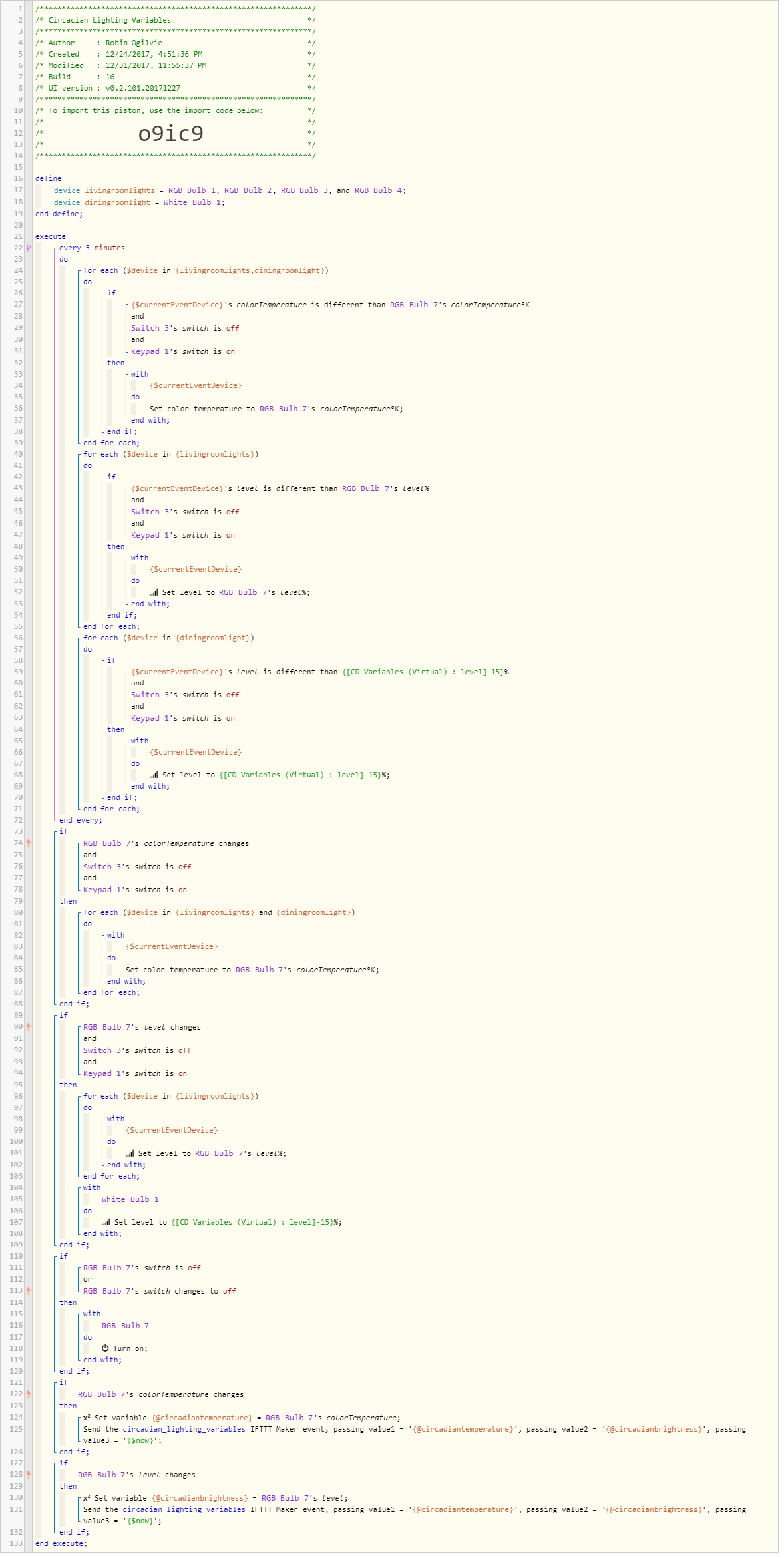

I created a piston to check the color temp/level of my bulbs in reference to 1 “simulated bulb”, and change my bulbs if they are different. Piston is here:
I’m consistently getting an error in my log, seems to be something to do with setting the Color Temperature, but I can’t make any more sense of it then that.

It looks like your diningroomlight is a white bulb and you’re trying to set it’s colorTemperature (which requires an RGB bulb).
It’s a white LIFX bulb, so it has colour temp options as well. Any idea how to fix it?
