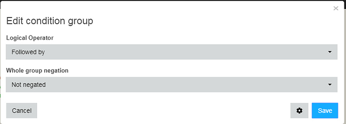

Actually, there is a “Followed By” command, meaning if there’s a second tap within…say…5 seconds, Webcore could respond to that second tap.
The problem, however, is that your first tap would always be delayed by those 5 seconds while Webcore is waiting to see if there’s a second tap. If the first tap turns on a light, then I doubt you want to wait 5 seconds for the light to come on.
[EDIT] Then again, if the first tap turns on a light, then an AND statement could work. IF the light is on AND the ON switch is pressed, then do X. You’d probably have to wait a sec for the light to come on first, and if you wanted the double-tap without the light, then this wouldn’t work.
There are Smart switches like the Inovelli and (I think) Zooz that respond to 1, 2, 3, 4, 5 taps (both up and down), but that means buying more switches, which I don’t think you want to do.
Thanks, I forgot about the Followed By operator. I’ll play around with it. I’d be using it to run a “Goodnight” routine, by double-tapping the off button, regardless of whether the controlled lights are on or off.
