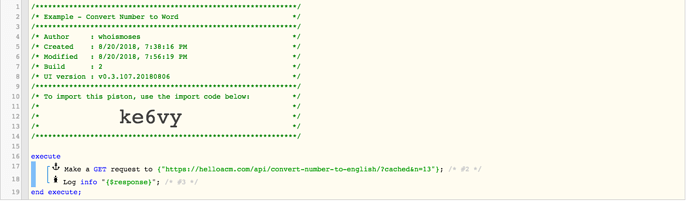

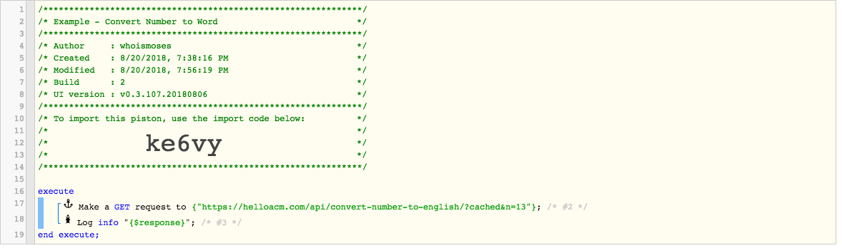

Anyone know why this web request fails?
A web request I’m making is failing. I’ve searched and can’t find this particular error in the forum.
Error executing external web request: javax.net.ssl.SSLException: java.security.ProviderException: java.security.InvalidKeyException: EC parameters error

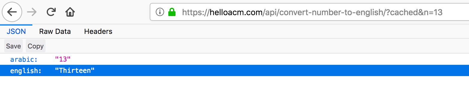

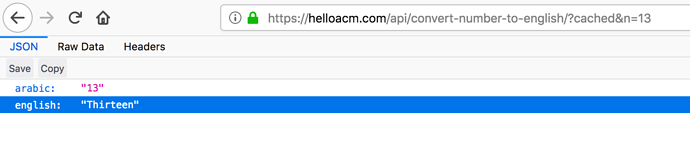

The following URL should return the results in JSON.
https://helloacm.com/api/convert-number-to-english/?cached&n=13

Here is a similar problem reported over on the ST forums, seems their platform is a bit outdated.
